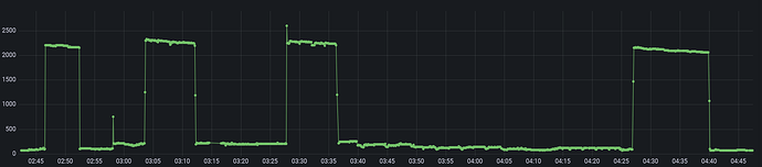

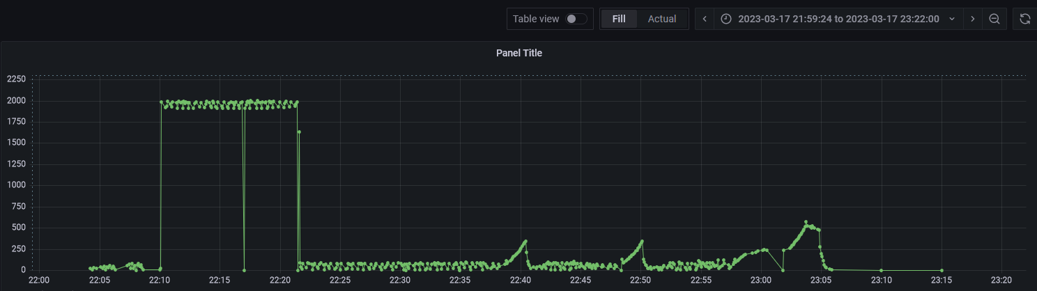

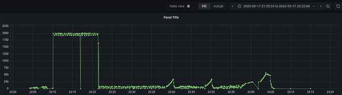

  1. Use Grafana to find a nice power profile of your DUO (e.g., Bosch washing machine):
  2. Export the data from your InfluxDB (adjust the parameters accordingly, start time and stop time can be gleaned from the headline in Grafana:
    grafik
    use the correct timezone in your query):
influx -username <username> -password <password> -database 'openhab' -execute "select * from ZBSteckdosemessend2Waschmaschine_Power WHERE time >= '2023-03-17T21:59:24+01:00' AND time <= '2023-03-17T23:22:00+01:00'" > bosch_program_1.power_profile

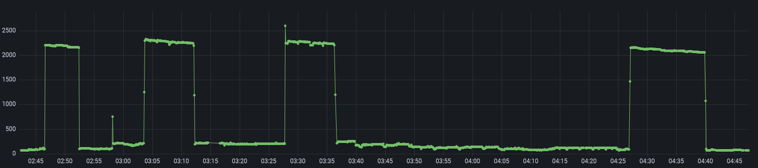

Power profile of my dishwasher (Bosch, 70°C, non-eco):
bosch_dishwasher_70_non_eco.power_profile.txt (84.9 KB)
tibber_rates_20230320_21.json (907 Bytes)
Result:
        hour    total cost
max:    19:33   0.47
min:    +21:51  0.37
max-min:        0.1
