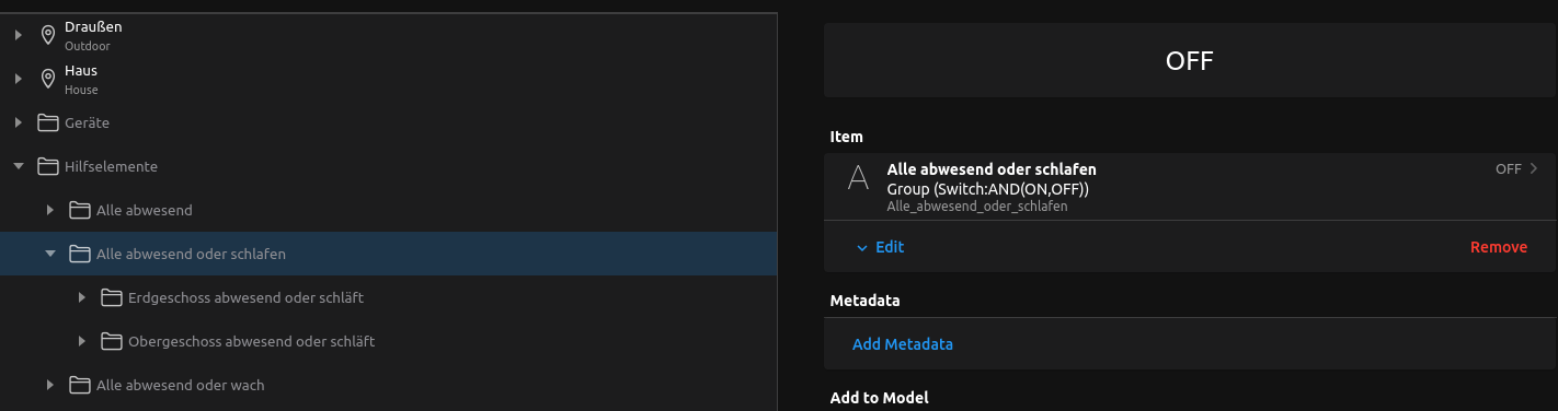

@rlkoshak Thank you very much for your answer!

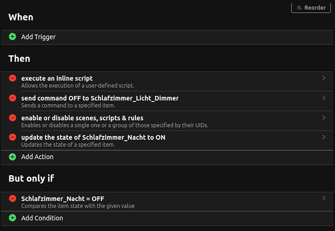

Actually, I’ve already done that but I don’t know if this is the right way.
I have an item for each room that is switched when the room is activated or deactivated.
In this example it’s the spleeping room.
You can hear the relays click when the light or shutter switches are activated even though they are already in the desired state, so I would like to politely disagree with you on this point.

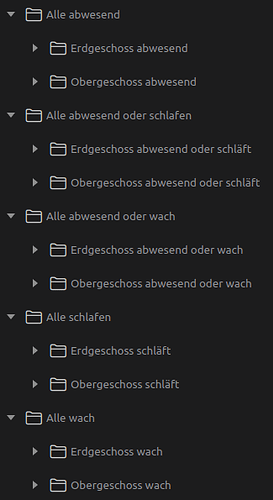

That’s what I meant by “computed” items
I have tried to achieve this by creating a rule for each room, which is then called up by other rules. Is that what you meant?
If people sleep on the upper floor, this floor is deactivated; if people sleep on the first floor, this floor is deactivated. When everyone is asleep, the house where the first floor and the upper floor belong is deactivated. So the last person to go to sleep triggers two rules in any case, at least so far.

It is unusual to have both an inlkine script and additional actions in a rule. Typically you would do it all in the script action.
Beyond that, as far as I can tell that’s a typical use for a rule condition.

I forgot to mention that the groups have the aggregate functions.
House deactivation is triggered by “all_away_or_asleep changed to ON”, which triggers the rules for the individual floors (including deactivating first floor which is a separate rule). Deactivation first floor is triggered by “groundfloor_away_or_asleep changed to ON”, but when I go to sleep, both events are triggered.
