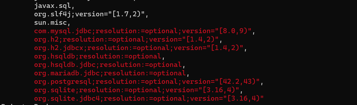

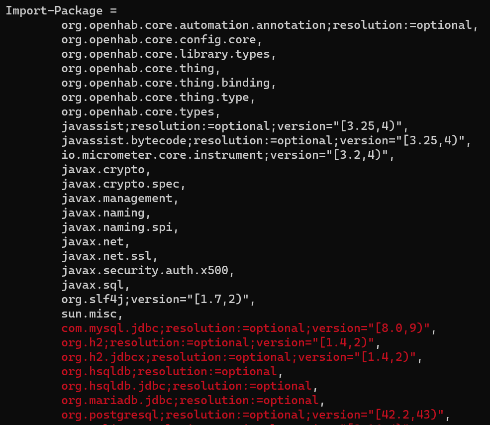

For a DBQuery addon, I have optional dependencies with jdbc drivers in the same way the jdbc persistence add-on does.
This works correctly in my local dev instance that is downloaded from nightly builds but not in my ‘production’ instance that is running 3.2M2.
The problem is that my addon is loaded and activated correctly, but the optional dependency for PostgreSQL isn’t enabled for the addon, despite it’s present and with the correct version:
Result of bundle:headers on the addon:

What is the result of diag on the dbquery bundle?
The result from bundle:diag is blank, because the addon starts correctly because the driver is an optional dependency. The problem is that it’s not available in the classpath to establish a connection to de database.
What I’ve tried is to remove the optional and then that’s the output from diag:
openHAB Add-ons :: Bundles :: DBQuery Binding (278)
Status: Installed
Unsatisfied Requirements:
osgi.wiring.package; filter:="(&(osgi.wiring.package=com.mysql.jdbc)(&(version>=8.0.0)(!(version>=9.0.0))))"; resolution:="optional"
osgi.wiring.package; filter:="(&(osgi.wiring.package=org.h2)(&(version>=1.4.0)(!(version>=2.0.0))))"; resolution:="optional"
osgi.wiring.package; filter:="(&(osgi.wiring.package=org.h2.jdbcx)(&(version>=1.4.0)(!(version>=2.0.0))))"; resolution:="optional"
osgi.wiring.package; filter:="(osgi.wiring.package=org.hsqldb)"; resolution:="optional"
osgi.wiring.package; filter:="(osgi.wiring.package=org.hsqldb.jdbc)"; resolution:="optional"
osgi.wiring.package; filter:="(osgi.wiring.package=org.mariadb.jdbc)"; resolution:="optional"
osgi.wiring.package; filter:="(&(osgi.wiring.package=org.postgresql)(&(version>=42.2.0)(!(version>=43.0.0))))"
osgi.wiring.package; filter:="(&(osgi.wiring.package=org.sqlite)(&(version>=3.16.0)(!(version>=4.0.0))))"; resolution:="optional"
osgi.wiring.package; filter:="(&(osgi.wiring.package=org.sqlite.jdbc4)(&(version>=3.16.0)(!(version>=4.0.0))))"; resolution:="optional"

Maybe tree-show <bundlename> on both machines shows a difference.
Thanks @J-N-K , I tried, but I don’t see any relevant difference. There are some because one is a nighty build and another M2, and also for other installed addons but in what is relevant to me are equal.
It’s possible a silly mistake, but by now, I’m not able to see anything. It’s very strange the diag fails with the mandatory postgresql dependency, but it seems to be present:
openhab> bundle:diag 280
openHAB Add-ons :: Bundles :: DBQuery Binding (280)
Status: Installed

I applied your suggestions but I still have problems with my production machine.
And I think that the problem is not the way I load the class, because when I do a bundle:headers the optional PostgreSQL dependency appears as red:
Refreshing the dbquery bundle, nor the driver one helps in any way and the result of bundle:headers always shows the postgres dependency in red.
The same running in my develop environment works correctly.
I attach some collected information:
277 │ Active │  80 │ 9.4.1212              │ PostgreSQL JDBC Driver JDBC42
281 │ Active │  80 │ 42.2.18               │ PostgreSQL JDBC Driver
282 │ Active │  80 │ 3.3.0.202201232027    │ openHAB Add-ons :: Bundles :: DBQuery Binding
package:imports -b 282
org.openhab.core.types                 │         │            │ 282 │ org.openhab.binding.dbquery
org.postgresql                         │         │ resolved   │ 282 │ org.openhab.binding.dbquery
org.slf4j                              │         │            │ 282 │ org.openhab.binding.dbquery
org.sqlite.jdbc4                       │         │ unresolved │ 282 │ org.openhab.binding.dbquery
org.sqlite                             │         │ unresolved │ 282 │ org.openhab.binding.dbquery
sun.misc                               │         │            │ 282 │ org.openhab.binding.dbquery

All except the bundle:headers seems correct, but I really know where to look.
I tried start/stop/refresh several times a system:shutdown --clean-caches,…
The only thing that seems to work in my production machine is to use an old version of the driver like the JDBC addon. But I don’t know if the real reason is that it’s already had been resolved by the persistence addon.
You have conflicting results since imports shows that postgresql is resolved while headers command show opposite. Have a look on postgresql driver exports cause coloring of headers verify package name and its version. Maybe for some weird reason, which I can’t tell now, there is a mismatch. Looking at headers and imports command sources I have impression that both do the same!
