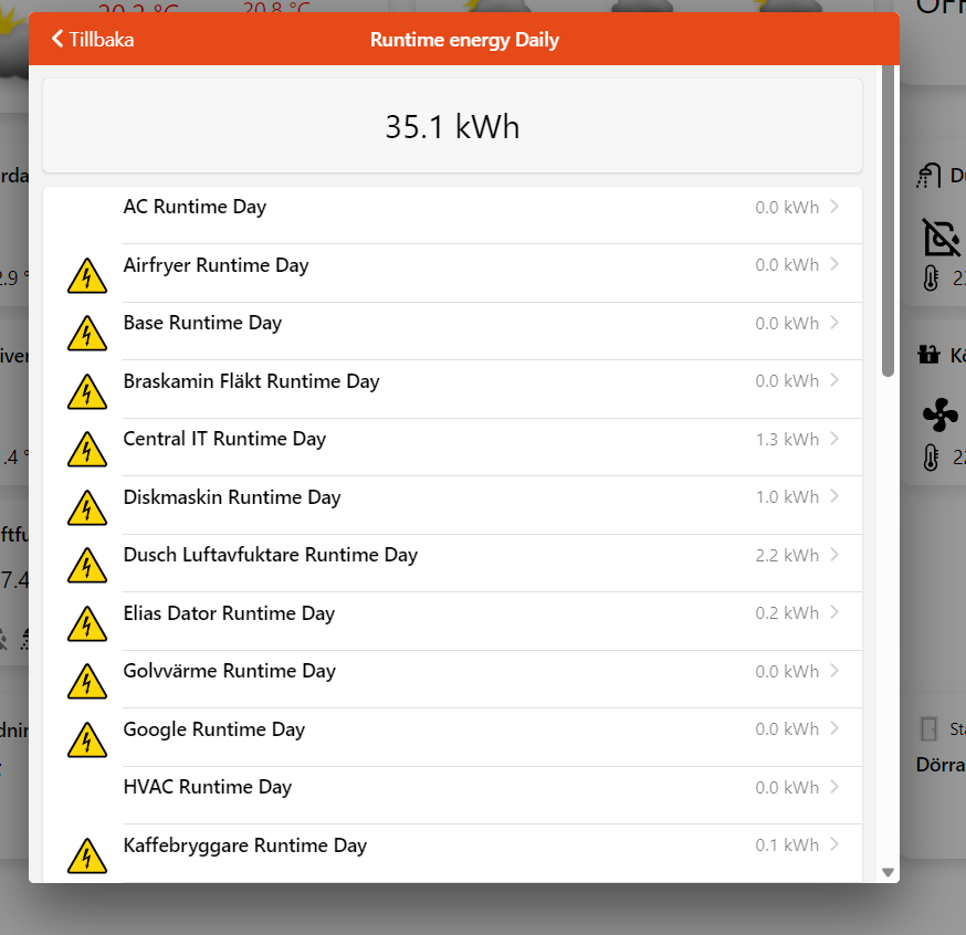

Is it not possible to order Action group actionGroupPopupItem by state falling.
I am displaying my energy consumption.
