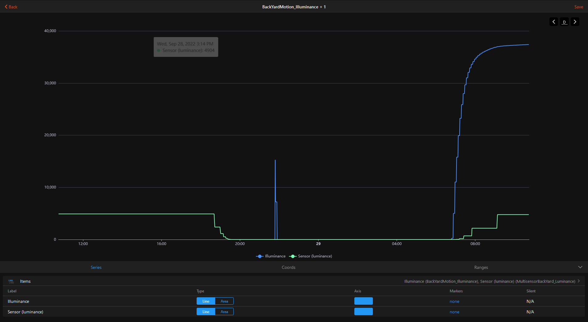

Sensor has been integrated and I’ve been watching the value as the sun has come up. The update rate of the Hue device is significantly more frequent than the Sensitive Strips Comfort. I’ve plotted my two devices to illustrate the difference (Hue in blue, Sensitive in green).
I don’t really care that the numbers are different from each other; I just need to know what sunny, cloudy, and dark look like for my rules to work. I’ll be doing a similar exercise with the temperature readings once I settle on a mounting location. Only complaint is that the device natively reports temp in Celsius and, because the rest of my system is set up to report Fahrenheit, it doesn’t take to the Number:Temperature item type (it reports the Celsius value but assigns the Fahrenheit unit). I made a quick rule to convert it but it would be nice to be able to work around it without the overhead.
Now just to see what the battery life is like with these frequent updates…
That must have been like watching paint dry.
