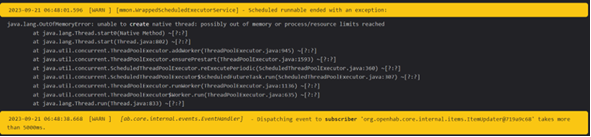

2023-09-21 06:47:15.675 [WARN ] [mmon.WrappedScheduledExecutorService] - Scheduled runnable ended with an exception:
java.lang.OutOfMemoryError: unable to create native thread: possibly out of memory or process/resource limits reached

With OOM exceptions, the exception is a symptom, not a cause. About the only useful information you will find there is the fact that an OOM exception occurred.
To find the memory leak itself is either going to take a lot of highly technical skills to hook a profiler up to OH while it’s running and analyze the memory to see what appears to be leaking memory. Or a lot of trial and error by removing add-ons in a systematic way until the OOM goes away. Then you’ll know which binding is causing the problem.
I agree it is most likely a specific binding as this is the first OOM error I’ve seen reported for OH 4.1. If it were in core, someone most likely would have experienced it before now and reported it.
There is one specific binding OOM reported [neeo] Excessive Thread Leak - HttpClient-*-SelectorManager · Issue #15563 · openhab/openhab-addons · GitHub, with a PR for a solution already created. If you use the Neeo binding or transport, that may be the culprit.
It is worth to say the binding did not change, and there was no growth in threads (memory usage) at all before. So something changed in core that caused this problem to appear now. It was bad design in the binding, but never caused a real problem so far. We have not been able to identify what change caused it. Maybe another binding is affected in a similar way.
What bindings do you use?
