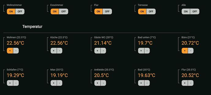

First of all, thanks for this great Theme. I worked on it a little bit and created some first dashboards.
Here some impressions…

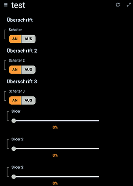

Hi guys,
I tried to use the Orange Tree theme. I want to use HABPanel on a tablet and Amazon Echo show 8 and my mobile phone.
This is my dashboard, which looks good on a tablet:
Using the mobile breakpoint it looks like this:
Is it possible to get a break that contains the content withe the red, green and blue border:
Thanks :slight_smile:
