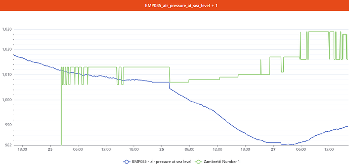

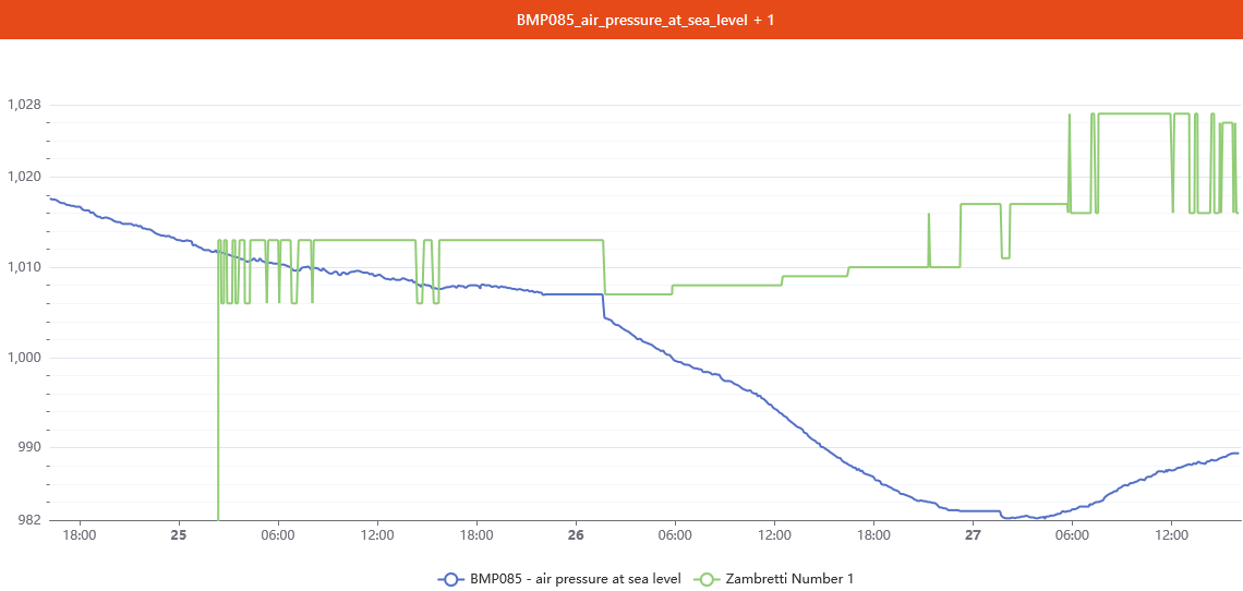

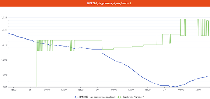

Zambretti at work:
Zambretti Number 1 (ZN1) is defined in relation to the Zambretti numbers from the DSL script (ZND):
  • ZN1 1001-1009: falling conditions ZND 1-9
  • ZN1 1010-1019: steady conditions ZND 1-10
  • ZN1 1020-1032: rising conditions ZND 1-13
Does the Zambretti forecaster work? Well, I’m not sure …
BTW, see Zambretti Forecaster - Wikipedia for the real device.
