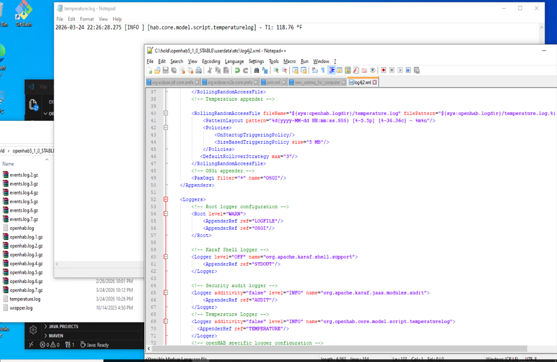

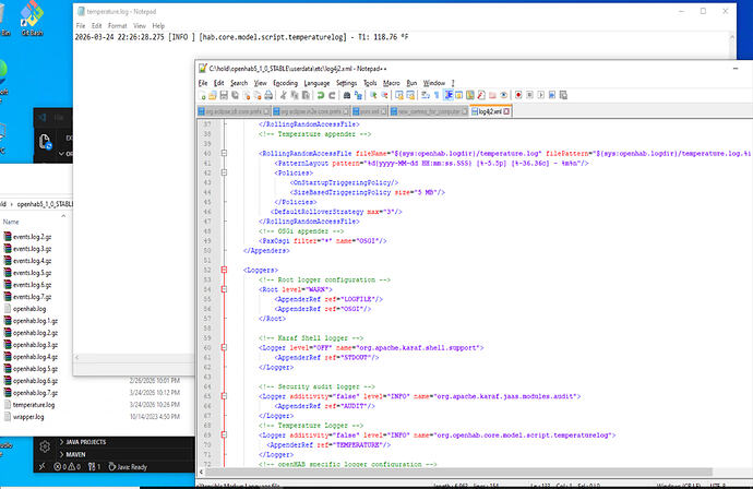

I dont understand it. I tried a lot of variants in the /var/lib/openhab/etc/log4j2.xml but it changed nothing. At the end I edited the standard logfile name openhab.log to openhabtest.log, but it changed nothing as well. After every change I make sudo systemctl restart openhab.
this works fine I took your log4j entries copied them into my openhab log4j.xml
I did however edit out the slashes you had in the pattern
restarted openhab and had a new temperature log file
then created this simple rule based on a shelly device I had that reports internal temperature and it correctly wrote to the new log.

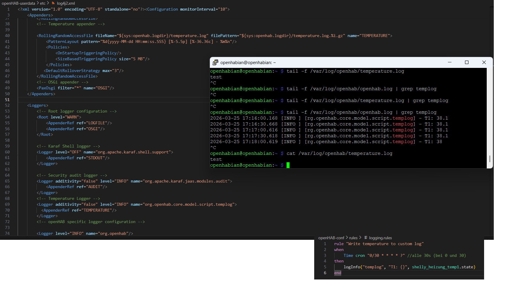

and this simple rule.
configuration: {}
triggers:
  - id: "1"
    configuration:
      cronExpression: 0 * * * * ? *
conditions: []
actions:
  - inputs: {}
    configuration:
      type: application/vnd.openhab.dsl.rule
      script: 'logInfo("temperaturelog", "T1: {}",
        ShellyPlus_Plug_Device_Status_Internal_Temperature.state)'
    type: script.ScriptAction
and this output

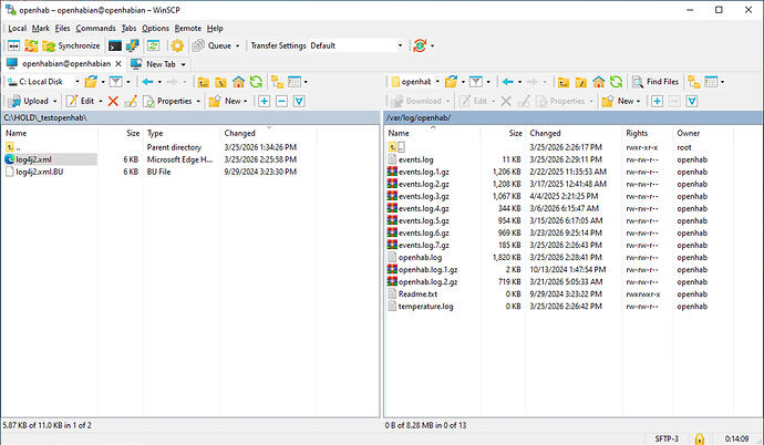

Hi, thanks for your answer.
I copied your xml to my log4j2.xml, but it is not working.
See my picture with the settings. (I dont have slashes in the xml)
Is there anything else that I have to configure?

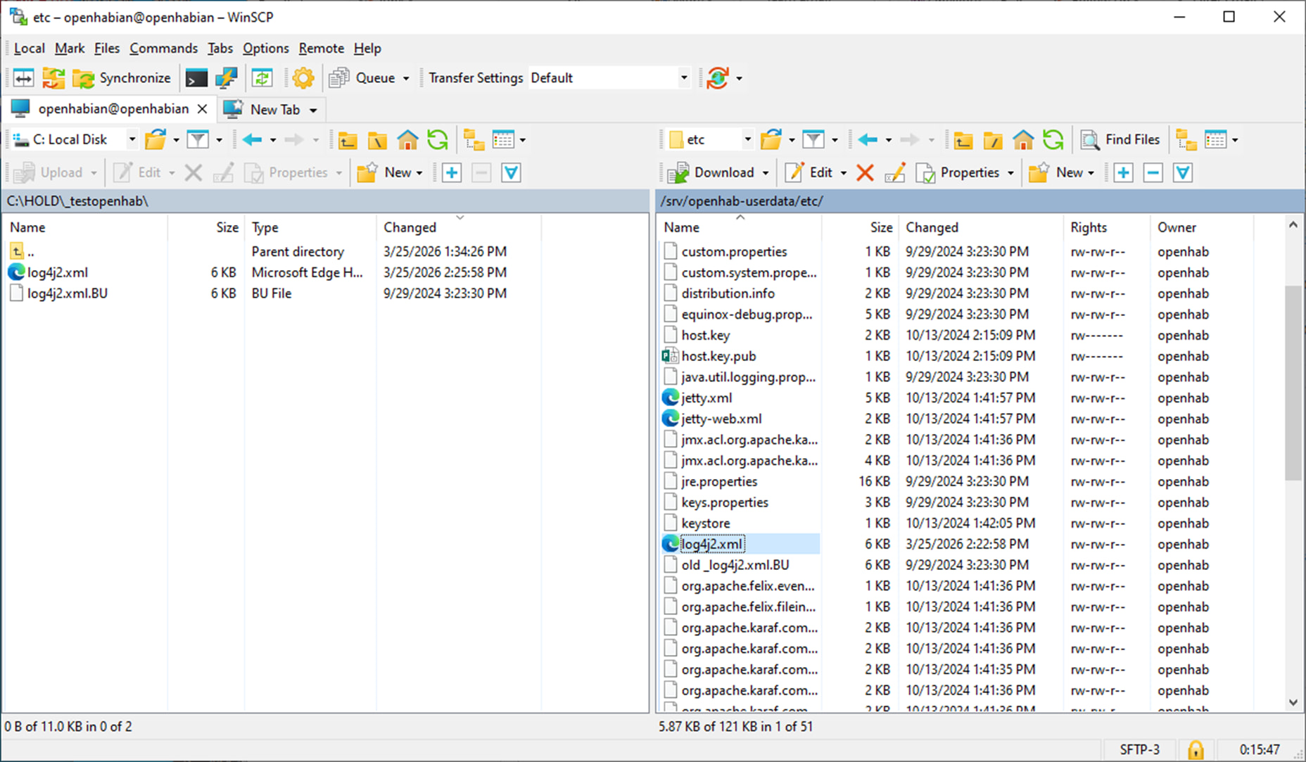

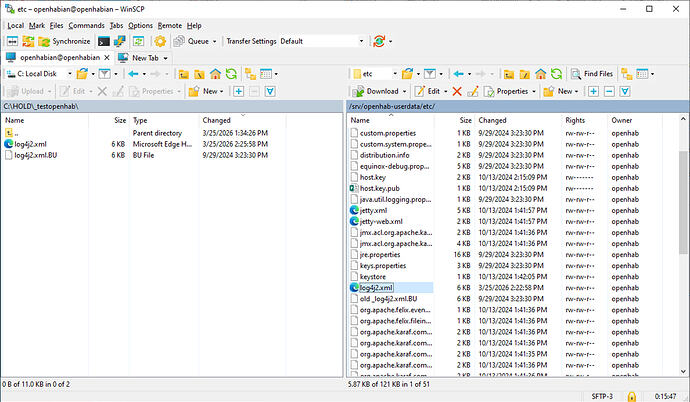

Additional I cant change the log4j2.xml directly, I must change it with sudo nano or I must copy the new file in tmp and move it to the \openHAB-userdata\etc.
How do you changed it?
No, I did not have to configure anything else I did it exactly as I posted nothing extra.

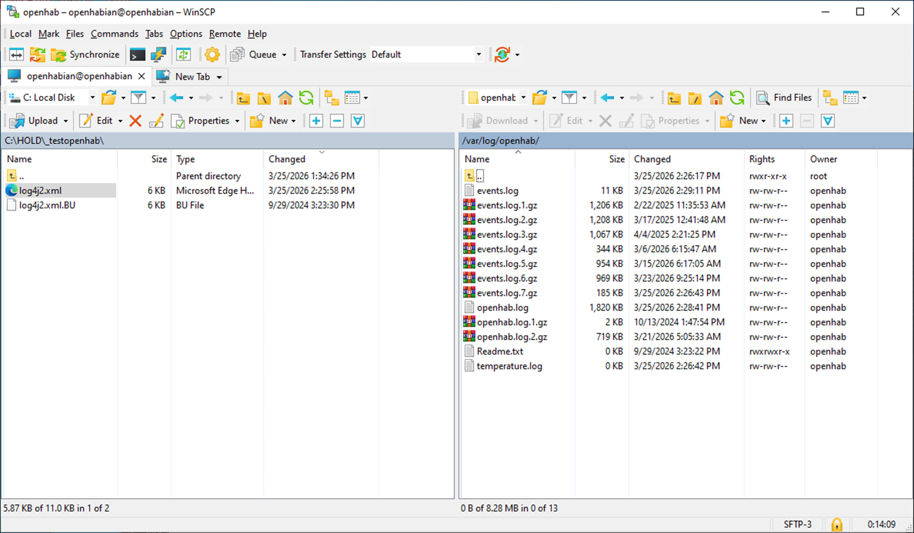

So, after you applied changes to the xml did you make sure the correct permissions are still on the file?
Did you restart openhab and did it create a new temperaturelog file in your logs folder?
if you have the log4j.xml correct it should create the new log file once you have that then any other issue is going to be with how you did your rules.
I removed the temperature.log to check it, after a restart there is no new temperature.log (I created the temperature.log by myself in the last days for testing).
I always make a sudo systemctl restart openhab after any changes.
How I can check the correct permissions of the xml? I belive the xml is not in use, because I changed the standard logfile name openhab.log to openhabtest.log, but it was still the openhab.log.
The rule is working, I see the trace every 30s in the openhab.log
if you have not gotten the xml file permissioned correctly and owned by openhab then it will not be able to read it and create and configure your new log file.
you check and change permissions on the xml file the same way you check or change permissions on any file in linux.
this statement right here says you have not gotten the xml correct.
If it is correct it will auto create that file with every restart
you need to check your ownership and permissions on that file.
I do not know how your are making these changes I can tell you how I do it (note I am lazy) I use winscp to copy over the file make my changes and copy it back I then change ownership and permissions from a console session. navigate to the correct location for the file then sudo chown username you want own the file here your file name here
so, for this one assuming you are in correct folder it would be
sudo chown openhab log4j2.xml
I got it :blush:.
The file org.ops4j.pax.logging.cfg in the same directory had the wrong content (I dont know why). Default is org.ops4j.pax.logging.log4j2.config.file=${karaf.etc}/log4j2.xml, but this line wasnt in the file. Instead this line there were the loggers and appenders configurations. I changed the content and I got immediately the temperature.log (without a restart).
Thank you for your help.
