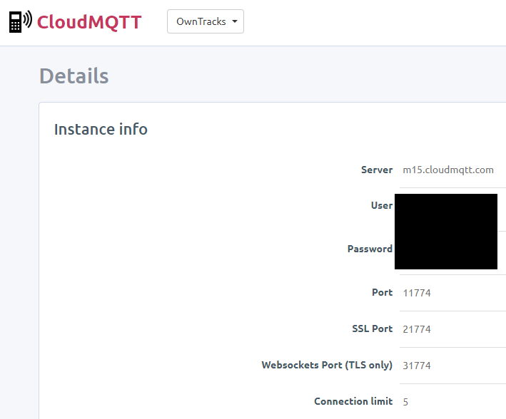

On the CloudMQTT website I can also see my connections from the Owntracks app, my mosquitto_sub command and the MQTT.fx applications I have running. I never see the connection Openhab.

I have the mqqt binding installed and configured as below. These match the cloudMQTT details.
mosquitto.url=tcp:m15.cloudmqtt.com:11774
mosquitto.user=openhabian
mosquitto.pwd=******
mosquitto.qos=1
mosquitto.retain=true
mosquitto.async=false
I have two users set up in cloudMQTT. One is for my phone, owntracks and one is for openhab.
I can see the connection from Owntracks on cloudMQTT. I can also see the other connections on cloudMQTT if I make them. For example using MQTT.fx program or if I run the mosquitto_sub command. I never see the connection from openhab though..

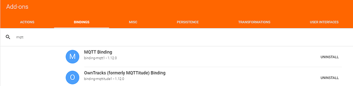

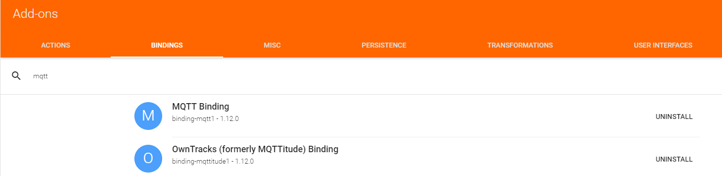

Just to be sure: You installed the MQTT 1.x binding from the legacy repository and not the binding that calls itself MQTT?
I installed MQTT using the paper UI. Version 1.12.0. Is not the correct binding?
Looks good. You don’t need to reboot. The connection should be established as soon as the configuration file changes, actually. But you haven’t looked into the logs yet have you?
