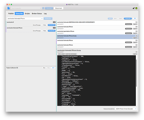

i subscribe with MQTT.fx to
owntracks/riotmode/iPhone
owntracks/#
both subs get infos
also when i hit “publish settings” / “publish waypoints” on the phone app i get some infos in mqtt.fx

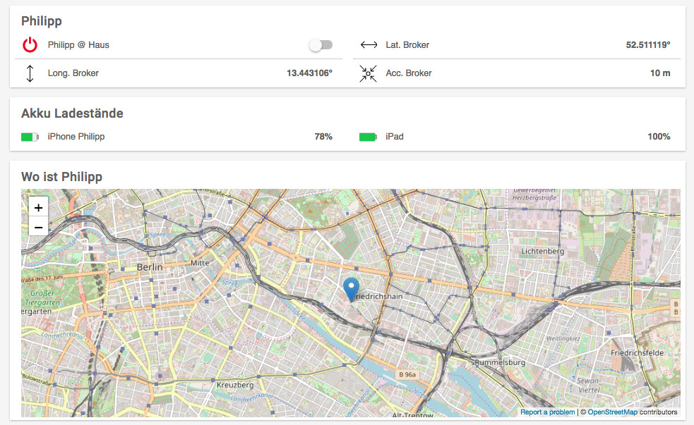

owntracks looks like this now :slight_smile:
Looks nice.
