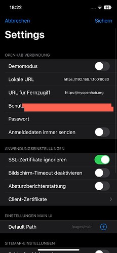

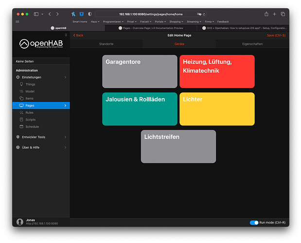

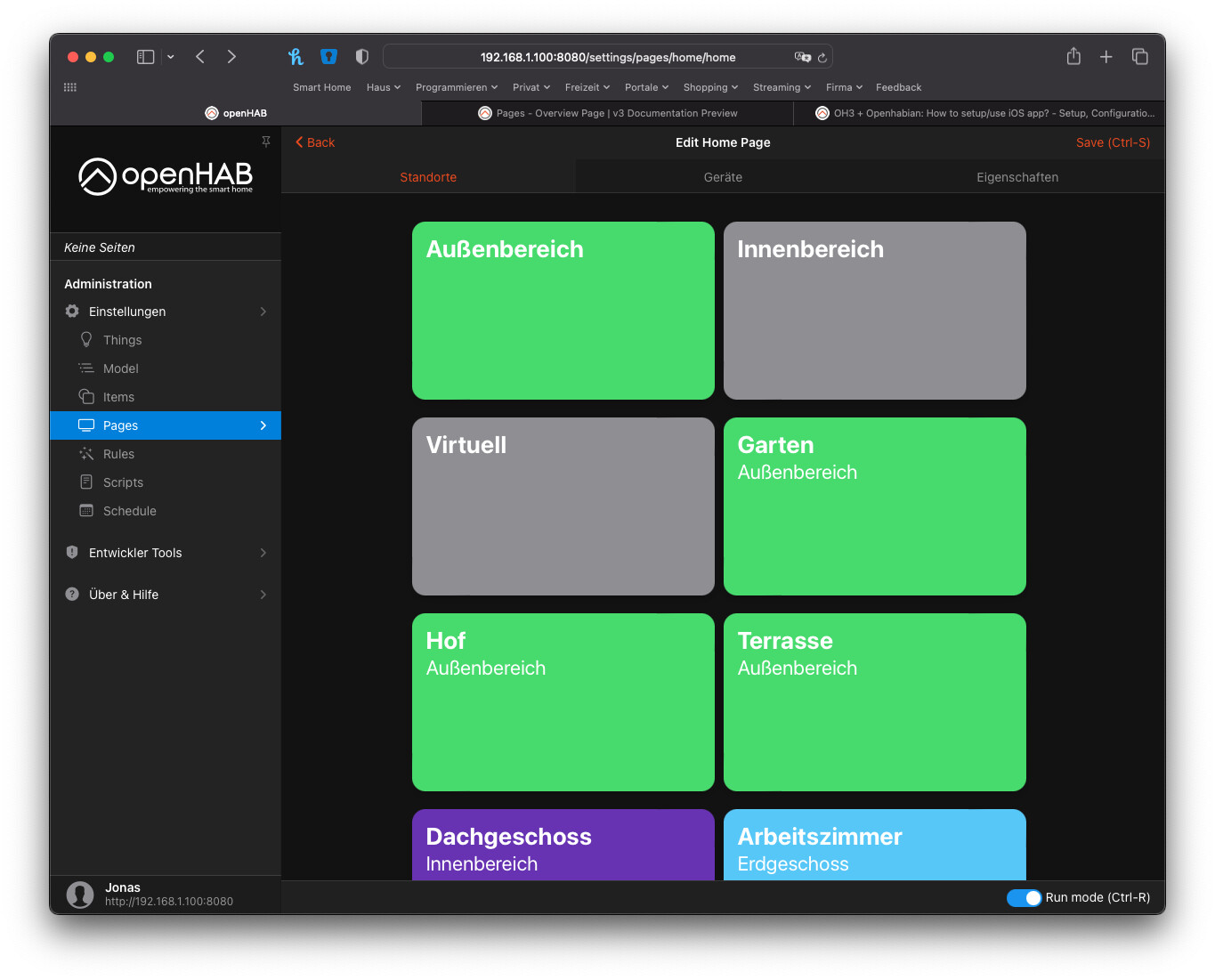

i set up the sematic model now and i want to display my home (mainly on my iPhone and iPad).
If i access with my computer i can find it under configuration but i am missing something. Do i have to “release” it somehow?
In the url there is still settings/home/home
Or is this page not for use at all and i have to manually configure a page? i hope not so :slight_smile:
Thanks for your help!
Your configurations shows that the model cards are only displayed to Users and Administrators.
So therefor you have to login.
You can also unselect the restriction so the model cards will be shown to anyone who has access to: 192.168.1.100:8080

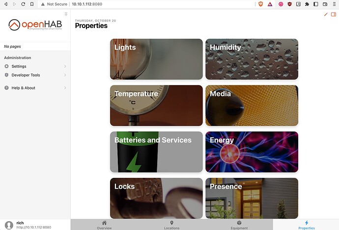

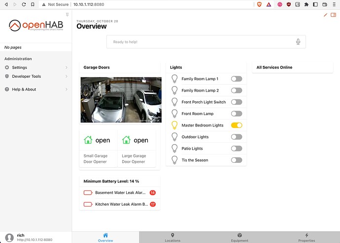

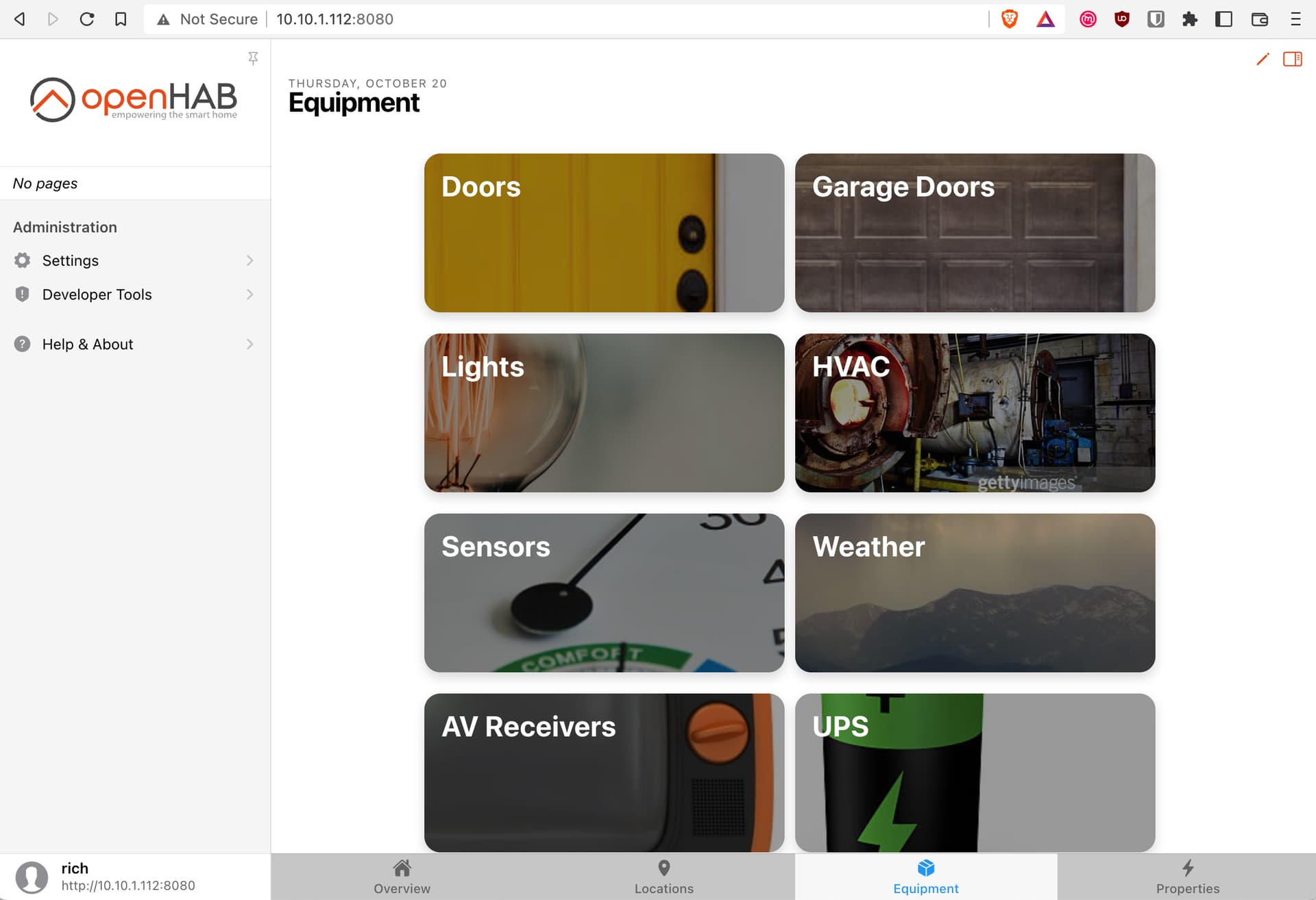

When you open the URL for your openHAB (e.g. http://192.168.1.100:8080/) it will open the overview page by default. The overview page consists of four tabs. The first is a Layout Page you need to create and configure and the remaining three are autogenerated based on the semantic model.
Notice the URL.
Note, if you click on the openHAB logo in the upper left corner, that will take you to the Overview page too.

Thank you for your replies!
I did not create the overview yet.
Is that the reason the app does not show anything? I dont know what to write in the field default path. Or is there another issue? Pw is set correctly.

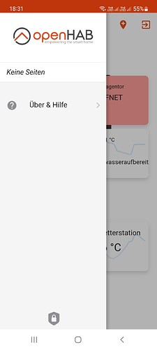

I think you are not logged in.
Please log in using the menue button on the top right.
Then you will see the model cards.
You don’t create the Overview page. It’s there by default. The first tab may be blank if you’ve not configured the layout tab yet but the other tabs will be populated from the semantic model.
Before you were talking about in the browser. If you are not talking about an app, which app? Android or iOS? I don’t think MainUI is supported in the iOS app yet (I could be wrong, I don’t follow the iOS app’s development). If the Android app you need to click on the hamburger menu (upper left corner) and select “openHAB 3 UI” to see MainUI.
Beyond that, assuming Settings → API Security → Implicit User Role is toggled on, there is nothing you need to do to create or see the Overview page. It’s there by default. It’s always there. You don’t create it.

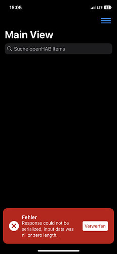

Hmmm.
It worked exactly once.
Then i tried it with WiFi turned off and got an error and now even local access is not possible anymore.
But the browser works fine. Thank you.

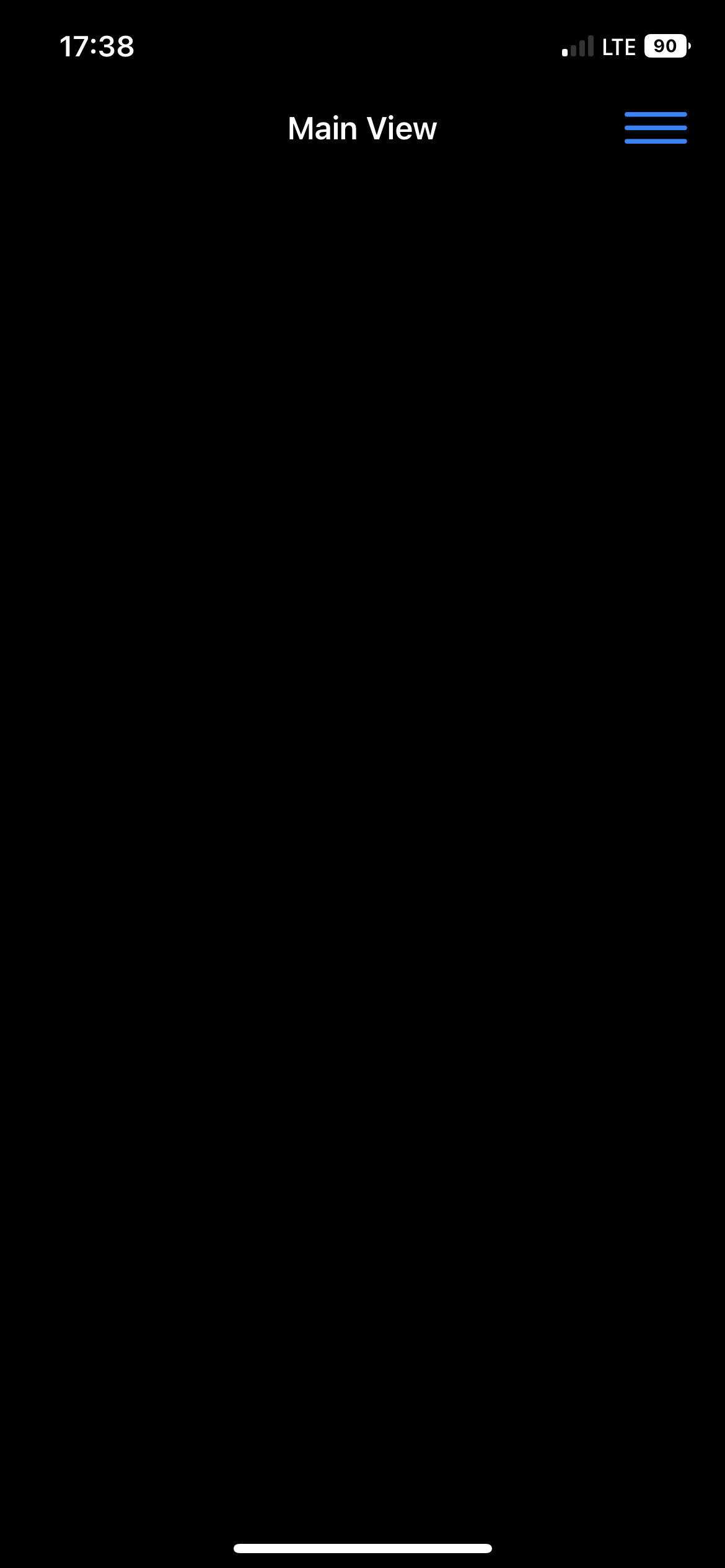

OH 4.3.4 - on Ubuntu 24 - I have the same problem
No matter what I write inside the YAML segment (e.g. oh-cards to point to other pages or a layout of a tabbed page.) The Overviews shows nothing (black) and I see no helpful log. Could you please post here the YAML code of the Overview page like you showed above (or an example) please? I would need just the overview - I would like so much to customize that page without hacking yetty… Thank you!
