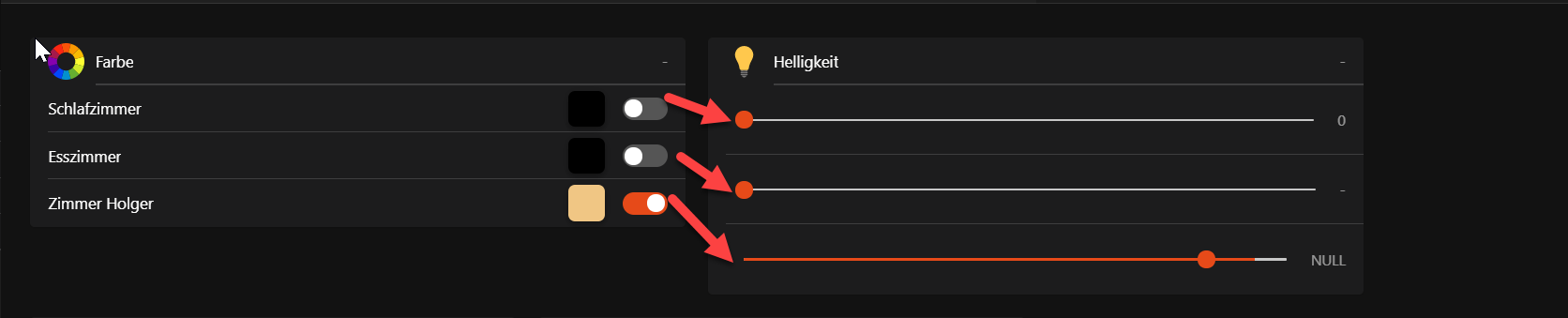

On the left, I’d like a label like room-name, and next to it have sliders etc. But since they have different heights, it doesn’t work.

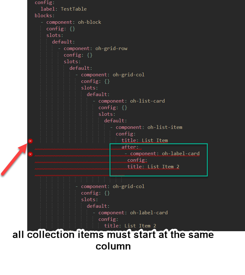

First I tried the “after” setting, but I didn’t get it to work. I could insert plain text, but not an additional field which I tried in the code. I copied Either I put it in the wrong spot:
Or it’s generally not allowed?:

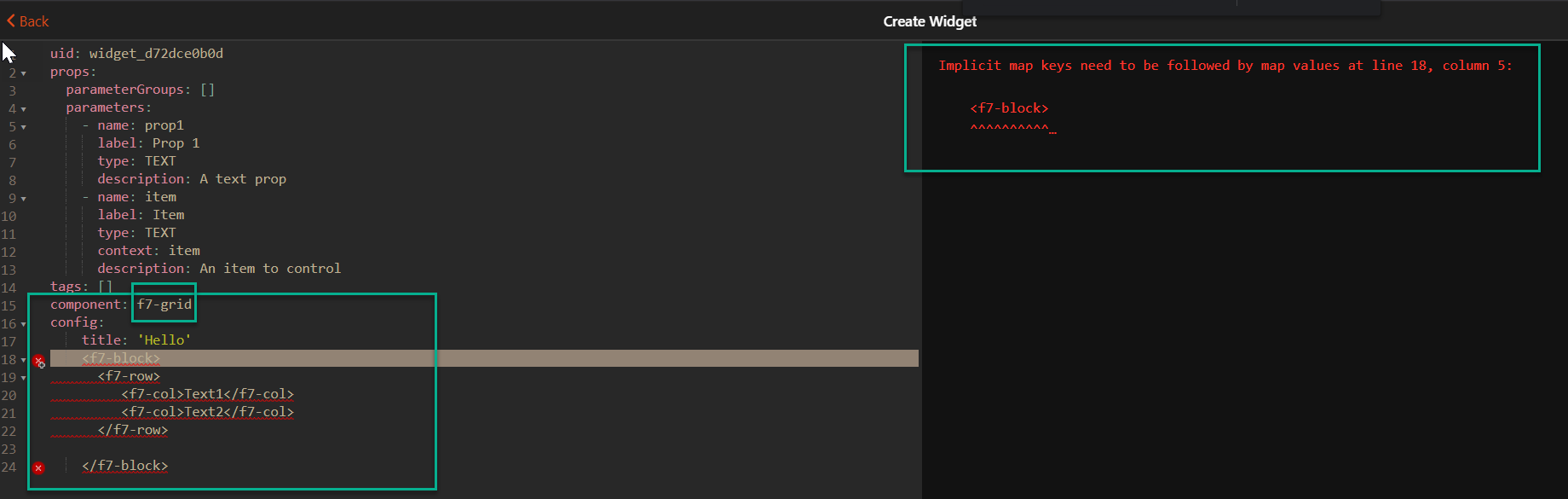

And when it comes to creating an own widget, I am somewhat lost. I looked in the framework7 description of “grid” which more or less seems to be what I’d like to get. From the given example, I tried to copy a small part into the widget-creation like this:
Which doesn’t work. No surprise, since I don’t really know what I’m doing there …

The funny thing about YAML is that it’s primary formatting is based on indentation and lining up of each of the lines of code. So it looks like some of your errors are just coming from lines that are not indented enough or too much. But in this particular case I think the problem is that there are two ways to access the various “slots” where you can insert things. As you discovered, if you are inserting plain text, you can just use the slot name as a map key for the object:
- component: oh-list-item
    title: List Item
    after: After text goes here
However, that shortcut method will not work when you are attempting to insert another widget. In order to do that you have to use the longer form which is the same as what you’ve used (copied) in all the steps above the list item in your example. That is, you have to explicitly access the list of the widget’s slots and then define which slot you are going to be putting a widget into:

This didn’t work because the example code given in on the f7 website is the html that actually constructs the widgets. You can’t mix that into the YAML. Under the hood, OH uses the YAML to construct that html by essentially using a blank html template for each widget and then filling in the important parameters based on the YAML configuration you supply. But using the f7 rows and cols would look very much like the oh rows and cols from your first example.

When I entered your widget-code and used the widget, it works. Now all I have to do is change the widget as to get the rows, columns and library-cards that I need. But with this basic structure, I should be able to get this done. And then there’s also the alternative with the after-part:

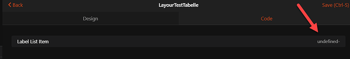

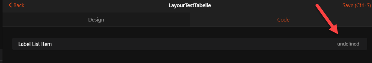

I thought I did it correctly this time, but I get an undefined message:
and here the result in run mode:
Probably/Hopefully just a minor change necessary?
Should be just a minor change. You’re missing the slots keyword above the after. You can only add widgets to these predefined slots so in order to nest a widget inside another you cannot use the keyword under the config heading you have to use the slots heading instead.

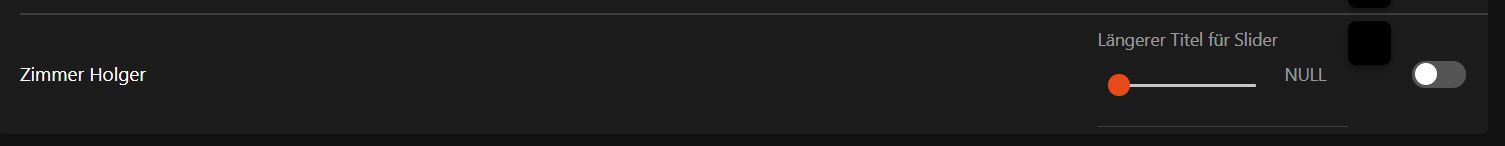

The slider’s length (within the colorpicker-item) depends on the length of the titel. Actually I don’t want a title at all. How can I define its length directly? There should be a property like “length” but I couldn’t find any such thing.

and this is what it looks like:
now all we need is a way to define the length of these items …
The style keyword will allow you to apply css styling to the widgets. In this case it sounds like you just want to adjust the width of the slider which is simply the width property.
