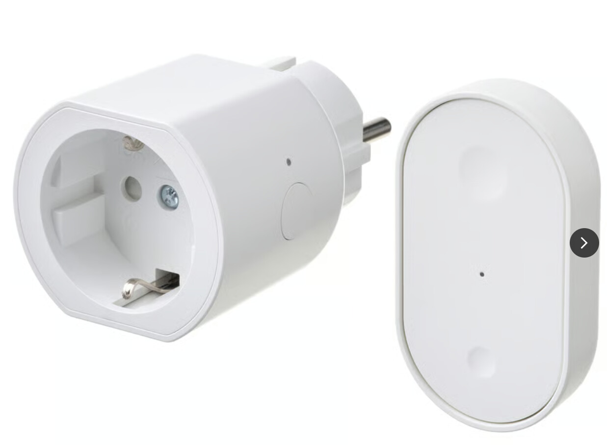

Newest addition was 2 Grillplats (BBQ-place :slight_smile: ) power plugs with remotes:
These, as mains powered devices, are adding more routers to the network:
Up to now, all other devices have had the 11 digit pairing code printed on the device itself together with a QR code which I have not used.
The Grillplats, however, have no 11 digit pairing code printed on the device itself, only a QR code. It was provided on a leaflet in the box, but that is risky if lost.
So, this is the way I was able to pair, using just the QR code. AI was helping along the way.

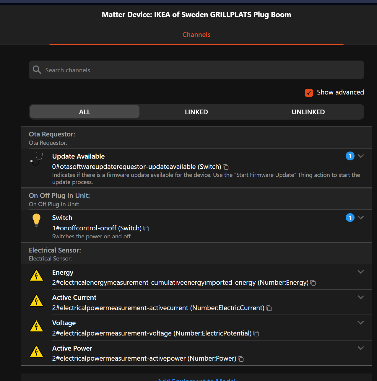

Note the pairing code to use in openHAB, good for 15min.
