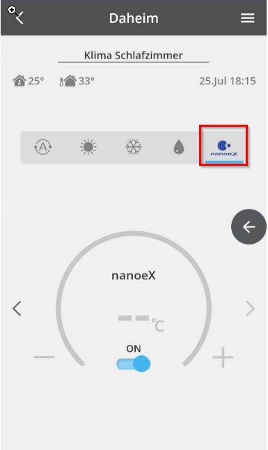

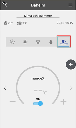

The binding have found this device CS-MZ16VKE, but I have not checked all features.
What I have found until now is, that the nanoeX operation mode is not available.
In the thing description description nanoeX (FAN) is missing.
When I activate the nanoeX feature in the app.
The operationmode shows “FAN” but.
When I change in the sitemap to nanoeX (FAN) the operation mode will not be transmitted to the app, all the other modes works.
I guess the nanoeX (FAN) operation mode is not implemented in the binding?
