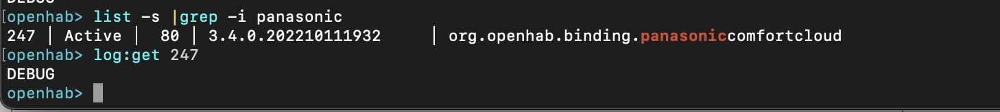

could you set the log level to DEBUG for this binding and post the logs as a private message?
Arne
Hi @seime,
Thank you so much.
I’ve set the log level to DEBUG but don’t see anything specific to this binding logged to openhab.log at all.
What am I doing wrong?
Try reloading the bundle. Should produce something in your log file. If not check your log4j xml file.
