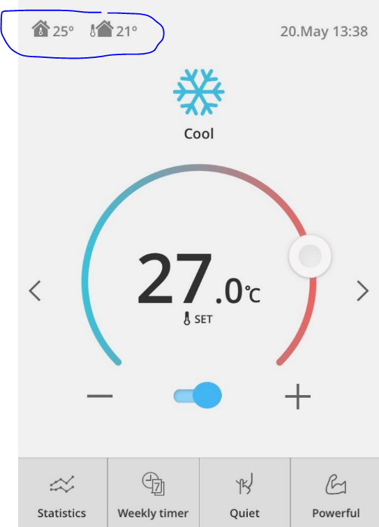

Btw, can you see inside and outside temperature in app? Because I have only outside temperature there.
Yes, I can see for the “split” units:
The KIT is reporting inside temp only, don’t know why and didn’t notice it before. Will report later regarding KIT unit.
It really seems only the split unit shows outdoor temp if switched off (wifi is on of course).
I have to turn my other kit unit (CS-Z25VKEW + CU-Z25TKE) ON to report the outdoor temp to the comfort cloud app.
