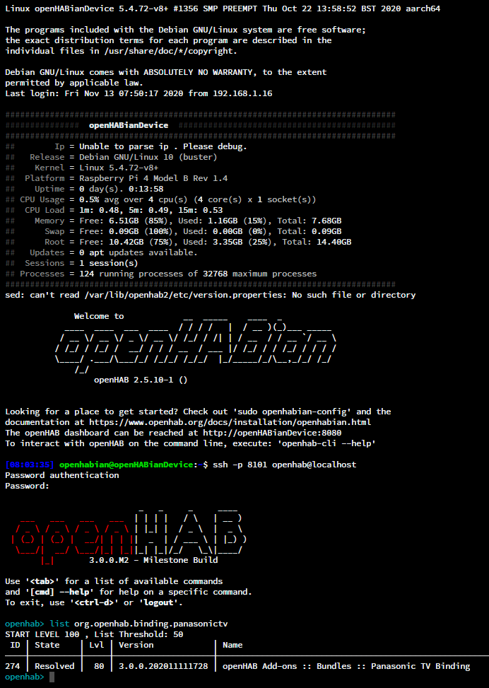

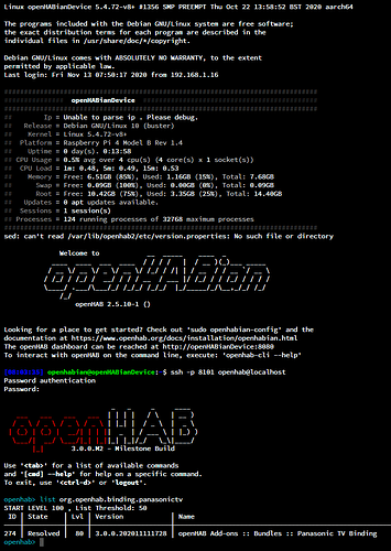

Awesome I tried installing and on the first go the bundle state is Resolved
Start the bundle and now it is active.

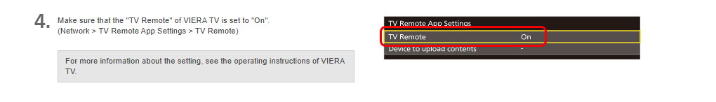

Can you use tha app to control tv
Setting looks like
This option is enabled and was enabled before. The v1 binding was working fine with these settings. I installed the Remote tv app Version 2 and Version 3. Both find the tv and I can use them.
