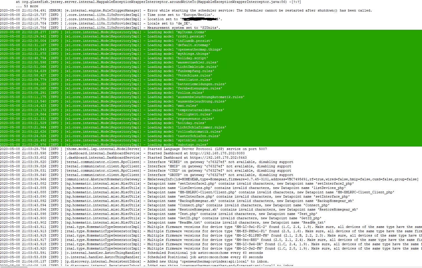

This is what’s in openhab.log after sudo systemctl restart openhab2
2020-05-08 21:01:11.248 [INFO ] [openhab.ui.paper.internal.PaperUIApp] - Stopped Paper UI 2020-05-08 21:01:11.327 [INFO ] [panel.internal.HABPanelDashboardTile] - Stopped HABPanel 2020-05-08 21:01:11.386 [INFO ] [ui.habmin.internal.servlet.HABminApp] - Stopped HABmin servlet 2020-05-08 21:01:11.455 [INFO ] [assic.internal.servlet.WebAppServlet] - Stopped Classic UI 2020-05-08 21:01:11.580 [INFO ] [basic.internal.servlet.WebAppServlet] - Stopped Basic UI 2020-05-08 21:01:21.644 [INFO ] [.dashboard.internal.DashboardService] - Stopped Dashboard 2020-05-08 21:01:42.382 [ERROR] [ersey.server.ServerRuntime$Responder] - An I/O error has occurred while writing a response message entity to the container output stream. [.. rest of IO Error Message removed by wbuh to keep it readable..] 2020-05-08 21:01:54.491 [ERROR] [e.internal.engine.RuleTriggerManager] - Error while starting the scheduler service: The Scheduler cannot be restarted after shutdown() has been called. 2020-05-08 21:02:18.737 [INFO ] [.core.internal.i18n.I18nProviderImpl] - Time zone set to 'Europe/Berlin'. 2020-05-08 21:02:18.779 [INFO ] [.core.internal.i18n.I18nProviderImpl] - Location set to 'xx.xxxxx,xxxxxx.xxxxxx'. 2020-05-08 21:02:18.784 [INFO ] [.core.internal.i18n.I18nProviderImpl] - Locale set to 'de_DE'. 2020-05-08 21:02:18.786 [INFO ] [.core.internal.i18n.I18nProviderImpl] - Measurement system set to 'SIUnits'. 2020-05-08 21:02:28.277 [INFO ] [el.core.internal.ModelRepositoryImpl] - Loading model 'myItems.items' 2020-05-08 21:02:29.942 [INFO ] [el.core.internal.ModelRepositoryImpl] - Loading model 'rrd4j.persist' 2020-05-08 21:02:30.004 [INFO ] [el.core.internal.ModelRepositoryImpl] - Loading model 'influxdb.persist' 2020-05-08 21:02:31.167 [INFO ] [el.core.internal.ModelRepositoryImpl] - Loading model 'default.sitemap' 2020-05-08 21:02:31.843 [INFO ] [el.core.internal.ModelRepositoryImpl] - Loading model 'openweathermap.things' 2020-05-08 21:02:31.878 [INFO ] [el.core.internal.ModelRepositoryImpl] - Loading model 'mythings.things' 2020-05-08 21:02:48.794 [INFO ] [el.core.internal.ModelRepositoryImpl] - Loading model 'holiday.script' 2020-05-08 21:02:50.598 [INFO ] [el.core.internal.ModelRepositoryImpl] - Loading model 'wasserzaehler.rules' 2020-05-08 21:02:51.066 [INFO ] [el.core.internal.ModelRepositoryImpl] - Loading model 'LichtUmkleide.rules' 2020-05-08 21:02:54.639 [INFO ] [el.core.internal.ModelRepositoryImpl] - Loading model 'funkempfang.rules' 2020-05-08 21:02:58.427 [INFO ] [el.core.internal.ModelRepositoryImpl] - Loading model 'Verschluss.rules' 2020-05-08 21:02:59.779 [INFO ] [el.core.internal.ModelRepositoryImpl] - Loading model 'ventilator.rules' 2020-05-08 21:03:04.155 [INFO ] [el.core.internal.ModelRepositoryImpl] - Loading model 'batteriemeldungen.rules' 2020-05-08 21:03:05.068 [INFO ] [el.core.internal.ModelRepositoryImpl] - Loading model 'fernbedienungen.rules' 2020-05-08 21:03:08.291 [INFO ] [el.core.internal.ModelRepositoryImpl] - Loading model 'rollos.rules' 2020-05-08 21:03:11.175 [INFO ] [el.core.internal.ModelRepositoryImpl] - Loading model 'aussenbeleuchtungAutomatik.rules' 2020-05-08 21:03:13.540 [INFO ] [el.core.internal.ModelRepositoryImpl] - Loading model 'aussenbeleuchtung.rules' 2020-05-08 21:03:14.423 [INFO ] [el.core.internal.ModelRepositoryImpl] - Loading model 'wwz.rules' 2020-05-08 21:03:18.172 [INFO ] [el.core.internal.ModelRepositoryImpl] - Loading model 'temperatursalden.rules' 2020-05-08 21:03:19.864 [INFO ] [el.core.internal.ModelRepositoryImpl] - Loading model 'helligkeit.rules' 2020-05-08 21:03:21.331 [INFO ] [el.core.internal.ModelRepositoryImpl] - Loading model 'regensensor.rules' 2020-05-08 21:03:21.529 [INFO ] [el.core.internal.ModelRepositoryImpl] - Loading model 'holiday.rules' 2020-05-08 21:03:21.964 [INFO ] [el.core.internal.ModelRepositoryImpl] - Loading model 'LichtSchlafzimmer.rules' 2020-05-08 21:03:22.626 [INFO ] [el.core.internal.ModelRepositoryImpl] - Loading model 'rollosAutomatik.rules' 2020-05-08 21:03:24.826 [INFO ] [el.core.internal.ModelRepositoryImpl] - Loading model 'tasterSchlafen.rules' 2020-05-08 21:03:25.492 [INFO ] [el.core.internal.ModelRepositoryImpl] - Loading model 'sprinkler.rules' 2020-05-08 21:03:26.976 [INFO ] [el.core.internal.ModelRepositoryImpl] - Loading model 'sabotage.rules' 2020-05-08 21:03:29.756 [INFO ] [thome.model.lsp.internal.ModelServer] - Started Language Server Protocol (LSP) service on port 5007 2020-05-08 21:03:33.598 [INFO ] [.dashboard.internal.DashboardService] - Started Dashboard at http://192.168.178.202:8080 2020-05-08 21:03:33.602 [INFO ] [.dashboard.internal.DashboardService] - Started Dashboard at https://192.168.178.202:8443 2020-05-08 21:03:39.820 [INFO ] [ternal.communicator.client.RpcClient] - Interface 'WIRED' on gateway 'c76327ef' not available, disabling support 2020-05-08 21:03:39.826 [INFO ] [ternal.communicator.client.RpcClient] - Interface 'HMIP' on gateway 'c76327ef' not available, disabling support 2020-05-08 21:03:39.831 [INFO ] [ternal.communicator.client.RpcClient] - Interface 'CUXD' on gateway 'c76327ef' not available, disabling support 2020-05-08 21:03:39.840 [INFO ] [ternal.communicator.client.RpcClient] - Interface 'GROUP' on gateway 'c76327ef' not available, disabling support 2020-05-08 21:03:39.966 [INFO ] [ommunicator.AbstractHomematicGateway] - HmGatewayInfo[id=HOMEGEAR,type=Homegear,firmware=0.7.45-3101,address=VBC7495691,rf=true,wired=false,hmip=false,cuxd=false,group=false] 2020-05-08 21:03:43.882 [INFO ] [ng.homematic.internal.misc.MiscUtils] - Datapoint name 'setInterface2.php' contains invalid characters, new Datapoint name 'setInterface2_php' 2020-05-08 21:03:43.885 [INFO ] [ng.homematic.internal.misc.MiscUtils] - Datapoint name 'listDevices.php' contains invalid characters, new Datapoint name 'listDevices_php' 2020-05-08 21:03:43.888 [INFO ] [ng.homematic.internal.misc.MiscUtils] - Datapoint name 'HM-XMLRPC-Client/Client.php' contains invalid characters, new Datapoint name 'HM-XMLRPC-Client_Client_php' 2020-05-08 21:03:43.890 [INFO ] [ng.homematic.internal.misc.MiscUtils] - Datapoint name 'setInterface.php' contains invalid characters, new Datapoint name 'setInterface_php' 2020-05-08 21:03:43.892 [INFO ] [ng.homematic.internal.misc.MiscUtils] - Datapoint name 'BackupHomegear.sh' contains invalid characters, new Datapoint name 'BackupHomegear_sh' 2020-05-08 21:03:43.894 [INFO ] [ng.homematic.internal.misc.MiscUtils] - Datapoint name 'Connect.php' contains invalid characters, new Datapoint name 'Connect_php' 2020-05-08 21:03:43.896 [INFO ] [ng.homematic.internal.misc.MiscUtils] - Datapoint name 'RestoreHomegear.sh' contains invalid characters, new Datapoint name 'RestoreHomegear_sh' 2020-05-08 21:03:43.898 [INFO ] [ng.homematic.internal.misc.MiscUtils] - Datapoint name 'Test.php' contains invalid characters, new Datapoint name 'Test_php' 2020-05-08 21:03:43.900 [INFO ] [ng.homematic.internal.misc.MiscUtils] - Datapoint name 'GetID.php' contains invalid characters, new Datapoint name 'GetID_php' 2020-05-08 21:03:43.902 [INFO ] [ng.homematic.internal.misc.MiscUtils] - Datapoint name 'ReadMe.txt' contains invalid characters, new Datapoint name 'ReadMe_txt' 2020-05-08 21:03:43.911 [INFO ] [rnal.type.HomematicTypeGeneratorImpl] - Multiple firmware versions for device type 'HM-LC-Sw1-Pl-2' found (1.C, 2.4, 1.9). Make sure, all devices of the same type have the same firmware version, otherwise you MAY have channel and/or datapoint errors in the logfile 2020-05-08 21:03:43.913 [INFO ] [rnal.type.HomematicTypeGeneratorImpl] - Multiple firmware versions for device type 'HM-ES-PMSw1-Pl' found (2.5, 1.6). Make sure, all devices of the same type have the same firmware version, otherwise you MAY have channel and/or datapoint errors in the logfile 2020-05-08 21:03:43.915 [INFO ] [rnal.type.HomematicTypeGeneratorImpl] - Multiple firmware versions for device type 'HM-LC-Bl1PBU-FM' found (2.1, 2.B, 2.2, 2.3). Make sure, all devices of the same type have the same firmware version, otherwise you MAY have channel and/or datapoint errors in the logfile 2020-05-08 21:03:43.917 [INFO ] [rnal.type.HomematicTypeGeneratorImpl] - Multiple firmware versions for device type 'HM-Sec-RHS' found (2.0, 2.1, 2.4). Make sure, all devices of the same type have the same firmware version, otherwise you MAY have channel and/or datapoint errors in the logfile 2020-05-08 21:03:43.918 [INFO ] [rnal.type.HomematicTypeGeneratorImpl] - Multiple firmware versions for device type 'HM-LC-Sw4-DR' found (1.C, 2.4, 1.9). Make sure, all devices of the same type have the same firmware version, otherwise you MAY have channel and/or datapoint errors in the logfile 2020-05-08 21:03:43.920 [INFO ] [rnal.type.HomematicTypeGeneratorImpl] - Multiple firmware versions for device type 'HM-LC-Sw2-FM' found (1.C, 2.8, 1.9). Make sure, all devices of the same type have the same firmware version, otherwise you MAY have channel and/or datapoint errors in the logfile 2020-05-08 21:03:53.591 [INFO ] [o.internal.handler.AstroThingHandler] - Scheduled Positional job astro:moon:home every 60 seconds 2020-05-08 21:03:53.839 [INFO ] [o.internal.handler.AstroThingHandler] - Scheduled Positional job astro:moon:home every 60 seconds 2020-05-08 21:04:08.137 [INFO ] [g.discovery.internal.PersistentInbox] - Added new thing 'openweathermap:uvindex:api:local' to inbox. 2020-05-08 21:04:08.145 [INFO ] [g.discovery.internal.PersistentInbox] - Added new thing 'openweathermap:weather-and-forecast:api:local' to inbox. 2020-05-08 21:04:11.016 [INFO ] [ui.habmin.internal.servlet.HABminApp] - Started HABmin servlet at /habmin 2020-05-08 21:04:11.322 [INFO ] [panel.internal.HABPanelDashboardTile] - Started HABPanel at /habpanel 2020-05-08 21:04:11.560 [INFO ] [openhab.ui.paper.internal.PaperUIApp] - Started Paper UI at /paperui 2020-05-08 21:04:18.342 [WARN ] [rm.AbstractFileTransformationService] - Could not transform '1.0' with the file 'szene_aussenbel.map' : Target value not found in map for '1.0' 2020-05-08 21:04:18.410 [ERROR] [ersey.server.ServerRuntime$Responder] - An I/O error has occurred while writing a response message entity to the container output stream. [.. rest of IO Error Message removed by wbuh to keep it readable..] 2020-05-08 21:04:35.559 [INFO ] [rthome.model.script.ventilator.rules] - Ventilatorautomatik initialisiert 2020-05-08 21:04:39.226 [INFO ] [rthome.model.script.Verschluss.rules] - Verschlussdaten OG aktualisiert (offen: 0, gekippt: 0, geschlossen: 3, unklar: 0) 2020-05-08 21:04:39.229 [INFO ] [.smarthome.model.script.rollos.rules] - Initialisiert und normalisiert
Maybe this is better to read:
There seem to be no issues with loading myitems.items.
Is it an idea to change some kind of log-level to find out why the items are not loaded?

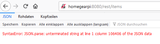

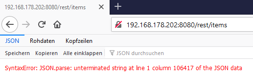

http://192.168.178.202:8080/rest/items
This returns
But I’m not shure if it’s intended to be used this way when you have a larger number of items.
On the other side: calling http://192.168.178.202:8080/rest/things works flawless!
The (end of) the raw data of the items request is

Did you note if it always fails at the same point in the listing, for a clue?

I gave it a try again to reduce my myitems.items file to only one item to find out what’s happening.
openhab.log said the myitems.items was refreshed.
And afterward:
So there is definitly something in the dark (db) that does not belong there!
The point it fails depends on the number of items. I added a few new items and the position changed.

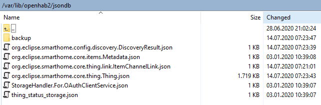

Yes, if you only use .items files you can delete the org.eclipse.smarthome.items.Item.json and org.eclipse.smarthome.core.thing.link.ItemChannelLink.json. Technically, if you’ve never used PaperUI to create Items or link them to Channel than neither of these files should exist in the first place of if they exist they would contain just [ ] as the file contents. Just make sure to stop openHAB first before deleting the files.
Definitely get the link file too. Sometimes an Item get’s removed but the link remains which confuses OH, leaving the Item in a zombie state, deleted but still in the list.

At least I got to the point to delete the json files
When I reduce my myitems.items file to only one, only this one appears. The obsolete items are gone. So far, so good. Thank’s to you guys for the hint.

	at org.openhab.transform.scale.internal.ScaleTransformationService.getScaleResult(ScaleTransformationService.java:132) ~[?:?]
	at org.openhab.transform.scale.internal.ScaleTransformationService.formatResult(ScaleTransformationService.java:126) ~[?:?]
	at org.openhab.transform.scale.internal.ScaleTransformationService.internalTransform(ScaleTransformationService.java:105) ~[?:?]
	at org.openhab.transform.scale.internal.ScaleTransformationService.internalTransform(ScaleTransformationService.java:1) ~[?:?]
	at org.eclipse.smarthome.core.transform.AbstractFileTransformationService.transform(AbstractFileTransformationService.java:138) ~[?:?]
	at org.eclipse.smarthome.core.transform.TransformationHelper.transform(TransformationHelper.java:125) ~[?:?]
	at org.eclipse.smarthome.core.transform.TransformationHelper.transform(TransformationHelper.java:100) ~[?:?]
	at org.eclipse.smarthome.io.rest.core.item.EnrichedItemDTOMapper.considerTransformation(EnrichedItemDTOMapper.java:124) ~[?:?]
	at org.eclipse.smarthome.io.rest.core.item.EnrichedItemDTOMapper.map(EnrichedItemDTOMapper.java:67) ~[?:?]
	at org.eclipse.smarthome.io.rest.core.item.EnrichedItemDTOMapper.map(EnrichedItemDTOMapper.java:61) ~[?:?]
	at org.eclipse.smarthome.io.rest.core.internal.item.ItemResource.lambda$0(ItemResource.java:230) ~[?:?]
	at java.util.stream.ReferencePipeline$3$1.accept(ReferencePipeline.java:193) ~[?:1.8.0_181]
	at java.util.HashMap$KeySpliterator.tryAdvance(HashMap.java:1574) ~[?:1.8.0_181]
	at java.util.stream.StreamSpliterators$WrappingSpliterator.lambda$initPartialTraversalState$0(StreamSpliterators.java:294) ~[?:1.8.0_181]
	at java.util.stream.StreamSpliterators$AbstractWrappingSpliterator.fillBuffer(StreamSpliterators.java:206) ~[?:1.8.0_181]
	at java.util.stream.StreamSpliterators$AbstractWrappingSpliterator.doAdvance(StreamSpliterators.java:169) ~[?:1.8.0_181]
	at java.util.stream.StreamSpliterators$WrappingSpliterator.tryAdvance(StreamSpliterators.java:300) ~[?:1.8.0_181]
	at java.util.Spliterators$1Adapter.hasNext(Spliterators.java:681) ~[?:1.8.0_181]
	at org.eclipse.smarthome.io.rest.Stream2JSONInputStream.fillBuffer(Stream2JSONInputStream.java:93) ~[?:?]
	at org.eclipse.smarthome.io.rest.Stream2JSONInputStream.read(Stream2JSONInputStream.java:69) ~[?:?]
	at java.io.InputStream.read(InputStream.java:179) ~[?:1.8.0_181]
	at java.io.InputStream.read(InputStream.java:101) ~[?:1.8.0_181]
	at org.glassfish.jersey.message.internal.ReaderWriter.writeTo(ReaderWriter.java:115) ~[bundleFile:?]
	at org.glassfish.jersey.message.internal.AbstractMessageReaderWriterProvider.writeTo(AbstractMessageReaderWriterProvider.java:79) ~[bundleFile:?]
	at org.glassfish.jersey.message.internal.InputStreamProvider.writeTo(InputStreamProvider.java:105) ~[bundleFile:?]
	at org.glassfish.jersey.message.internal.InputStreamProvider.writeTo(InputStreamProvider.java:60) ~[bundleFile:?]
	at org.glassfish.jersey.message.internal.WriterInterceptorExecutor$TerminalWriterInterceptor.invokeWriteTo(WriterInterceptorExecutor.java:265) ~[bundleFile:?]
	at org.glassfish.jersey.message.internal.WriterInterceptorExecutor$TerminalWriterInterceptor.aroundWriteTo(WriterInterceptorExecutor.java:250) ~[bundleFile:?]
	at org.glassfish.jersey.message.internal.WriterInterceptorExecutor.proceed(WriterInterceptorExecutor.java:162) ~[bundleFile:?]
	at org.glassfish.jersey.server.internal.JsonWithPaddingInterceptor.aroundWriteTo(JsonWithPaddingInterceptor.java:106) ~[?:?]
	at org.glassfish.jersey.server.internal.MappableExceptionWrapperInterceptor.aroundWriteTo(MappableExceptionWrapperInterceptor.java:86) ~[?:?]
	... 53 more
