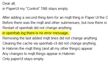

in PaperUI my “Control” TAB stays empty.
After adding a second thing item for an mqtt thing in Paper UI the Control page does not load anymore.
Before there was the mqtt and other submenues, but now there is only white space.
Restart of openhab did not change anything.
in openhab.log there is no error message.
Removing the last added mqtt lines did not change anything.
Clearing the cache via openhab-cli did not change anything.
In Habmin the mqtt thing (and all my other things) appear.
Any changes to mqtt.things appear in Habmin.
Only paperUI stays empty.
Where to start?

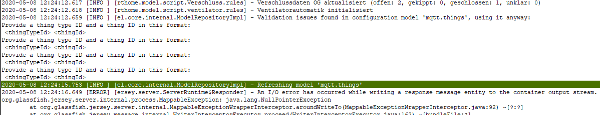

The in openhab.log following I/O Error appears every few seconds and seems to have nothing to do with the paperui problem. Even if I delete mqtt.things this error still appears.

This is the error message that was denied.
Still: Your thing definitions are incorrect, that’s what your earlier posted log does show as an error.

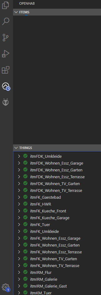

But I found out, that the things seem to be rendered fine, but there must be a problem with the items.
E.g. VSCode shows all things, but the item section renders until eternity and shows nothing.
So I again did a sudo openhab-cli clean-chache and restarted.
The items and things appeared in VSCode again, but all items were not assigned to a group. The items group appeared, but had no items in them.
The openhab.log showed many errors about unknown items for REST value assignments.
The IO-Error did not appear.
After I let the system com to rest for a few moments I rebooted again.
After this boot everything was back to the beginning: no items under paperUI-Control page.
VSCode shows things but no items.
So my conclusion is, there went something wrong with the “internal item database”.
