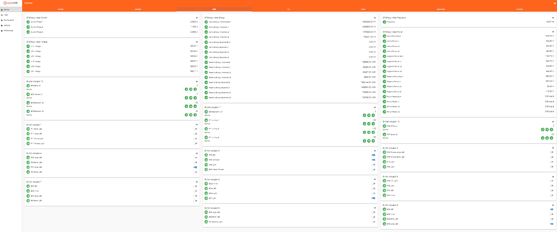

So in PaperUI in the Control tab, the boxes (cards) are not aligned well. I will post a screenshot below. There are huge white “spaces” in the tab. It makes it a little uncomfortable to use. Mainly I use it for debugging, testing something before creating sitemap/HabPanel for it, and it makes it a little bit harder (the bigger the screen, it will make it more harder). On phone it looks ok, because it is only has a one-row design.

It’s not a problem that everything is under the ‘Other’ tab, but the cards itself are not aligned well. If you see my screenshot, then you can see that the left and middle column are empty (and this is not the bottom of the page). I have a lots of these empty spaces between these cards…

there are 3 columns
it seems that you have only 3 things in the “Other” Control Tab
they are placed correctly in the layout
the “problem” is that your Spotify Thing has a large number of Items within its grouping and this extends the length of the page, leaving empty space on column 1 & 2 below the other Thing groups (aka cards).
You can’t split the (card) grouping of the Items from 1 Thing in other columns.
If this was possible: How would you know to which Thing the split Items belong to?

Yes, but as you can see on the scrollwheel that ‘Spotify’ item doesn’t consume that much space. I have much more items below that item (on the left, middle and right column as well).

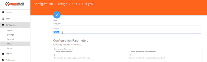

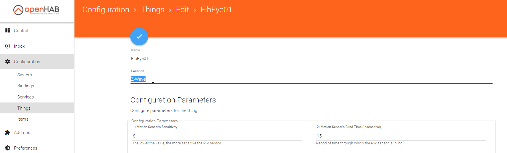

(modify the “Location” of your Things to place them under different Control tabs)
I see the screenshots… strange… this doesn’t happen to my tabs… they are autoaligned
Oh thanks :slight_smile: I didn’t know what that ‘Location’ was for until now :slight_smile:
