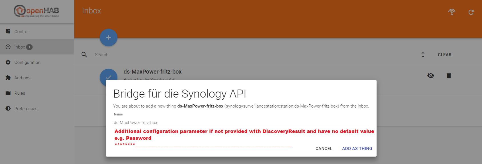

I’m working on a binding for a password protected network device. I’m able to discover the device in my LAN and add it to the inbox. In the Inbox a user would then click on this device and be able to enter its label only. As at this point discovery knows no credentials to connect to this device, the Thing is instantly OFFLINE. A user must first open the Thing, enter credentials, update and reinitialize the Thing.
My question: is there a possibility (or a ToDo) to prompt for additional information while adding a Thing from Inbox? For example, if a Thing have 5 configuration entries and but 3 were provided with DiscoveryResult, PaperUI would prompt for the other two?
(Edit: see picture)
Thank you in advance

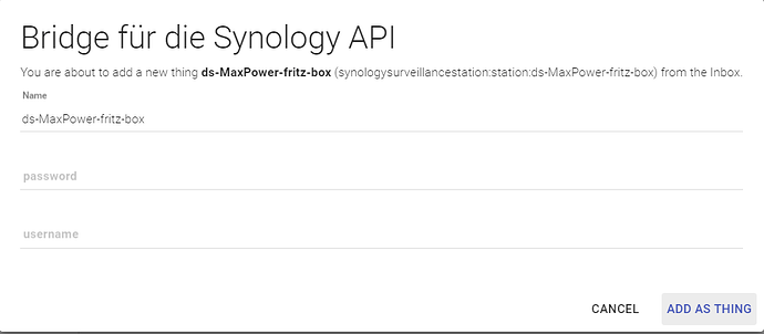

Third solution would involve prompting for empty properties upon adding a Thing from Inbox:
     <md-input-container class="col-xs-12 noPadding"> <label>Name</label> <input ng-model="label"> </md-input-container>
+    <div ng-repeat="(key, value) in properties">
+       <md-input-container class="col-xs-12 noPadding" ng-if="value===''"> <label>{{key}}</label> <input ng-model="properties[key]" > </md-input-container>
+    </div>
… and POSTing them as JSON string along with Thing label to the approve() in InboxResource.java and further into the core. This approach is the most complex but also the most elegant one (see picture).

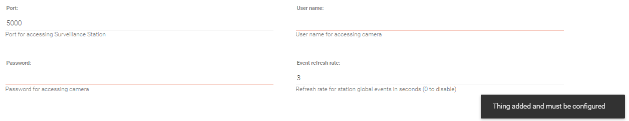

That is weird. I’m using 2.5.0. Username and password are declared as required. Thing is discovered. I click it, click on “Add as Thing” and I’m redirected with “Thing added and must be configured” message:
If I enter credentials, Thing goes ONLINE. If I leave this form without saving, Thing keeps its state: HANDLER_CONFIGURATION_PENDING as expected.
