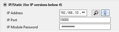

I have my Paradox with latest firmware:
EVO192 256K 7.11.006
IP150 4.42.002
This version of IP150 firmware allow you to connect from in-Field using direct connect (this function was removed in previous firmware). but to connect I need to provide also panel ID. in your plugin i can’t setup panel ID, as result I can’t connect.
Ed
sorry for the delay but I had too much other stuff recently.
I never used in-field, I use babyware. As far as I remember there is no such need there. Have you tried it?
Please check the very first post here. Can you enable debug as mentioned there and try without panel ID and provide me the logs so I can verify what happens with this firmware version. If direct connect is indeed possible, maybe it worths to try to adapt the binding for this latest version…
Cheers,
Konstantin
Yes I use babyware v5.2.5 and also can connect to my paradox without any problems.
With Last firmware it’s now possible (it was not possible with before).
Let me enable debug mode and send you details
Edward
