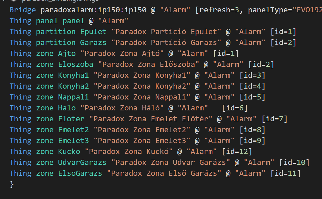

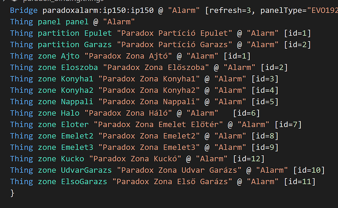

So I figured the issue that Ed has. It’s because of the usage of ā€œthing labelā€ @ ā€œthing locationā€ approach. It seems that for this binding it does not work correctly or is not supported when used in a bridge { Thing…} type definition the way I’m using it in the README and in my configuation files..
My one looks like this:
id numbers are coming from the panel Partition and Zone ID’s.
Weird… I did exactly the same configuration and it’s behavior is very inconsistent (Things getting OFFLINE/UNINTIALIZED), etc…
What I see different is that you’re missing Bridge label and panel label. That’s the only difference. I’ll test with that further when I have time… :frowning:
No, check first two lines. Exactly same as in your example here:
I’ve just not copied the complete bridge line as it contains user name and password.
