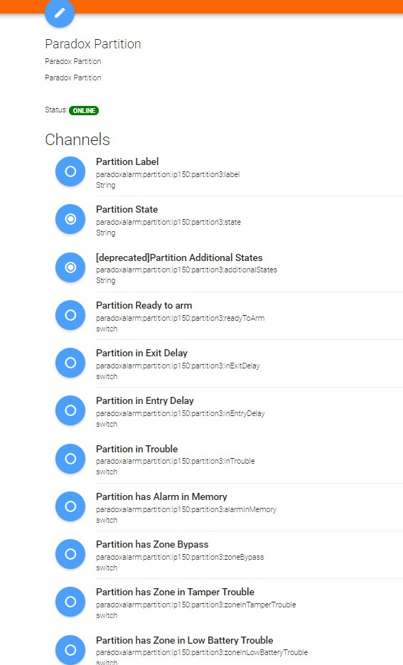

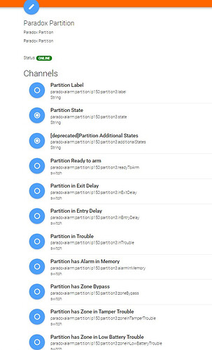

I’ve pushed into binaries repo one new small feature. Would be great if someone can test it (beside me). The new .jar is this one:
I figured I had to stop openhab and remove /openhab/userdata/tmp/* and /openhab/userdata/cache/* in order the changes to take effect.
What is expected is… to work like before of course and also to have more read-only channels on partitions. See the screenshot below.
