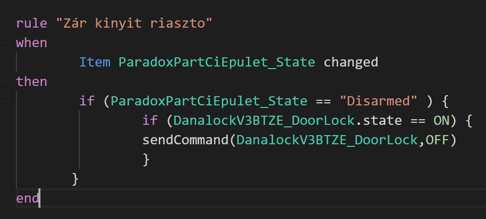

I agree with you. Probably You can check with the Founders how safe myopenhab.org connection is. There was a discussion with the GPSTracker - Bindings | openHAB binding as well. It was finalized recently. If somebody wants he can change to direct access skip using of myopenhab.org. I use this GPStracker and Network binding and some sensors to control my smartlock when I’m leaving and arrive home. My example would be that I would like to have armed/disarmed and zone statuses and I do not want to control (arm or disarm) alarm through Openhab. But I’d like to control my smartlock based on armed/disarmed statuses. I made a rule but no success. Here is the status change in the log file:
2019-01-15 09:22:36.022 [vent.ItemStateChangedEvent] - ParadoxPartCiEpulet_State changed from Disarmed to Armed
Here is the rule expression:
rule “Zár kinyit riaszto”
Item ParadoxPartCiEpulet_State changed
if (ParadoxPartCiEpulet_State == DISARMED ) {
if (DanalockV3BTZE_DoorLock.state == ON) {
sendCommand(DanalockV3BTZE_DoorLock,OFF)
I tried
ParadoxPartCiEpulet_State == Disarmed
ParadoxPartCiEpulet_State == “Disarmed”
but non of the expressions were good. Do you have a guess how should I use?

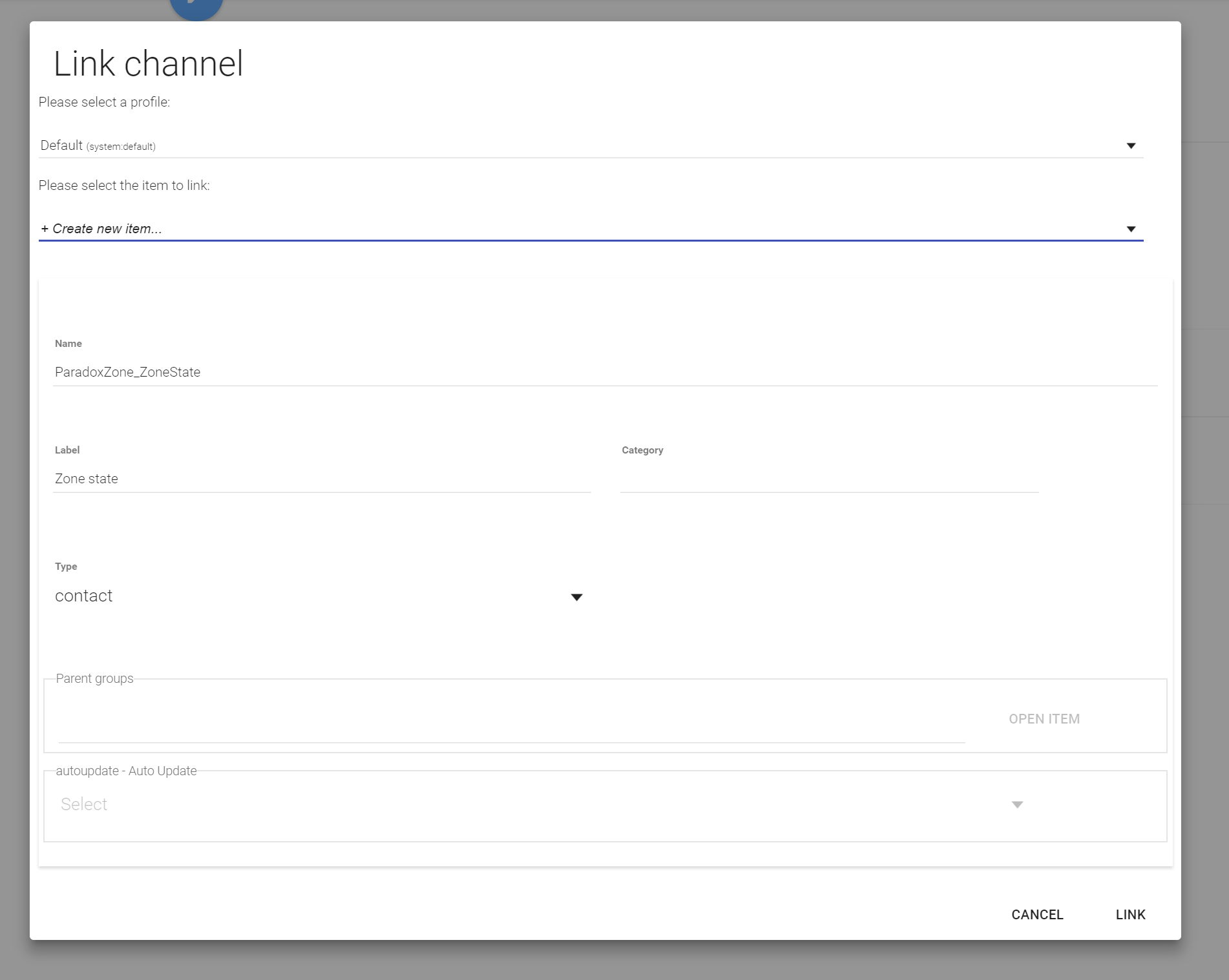

I’ve just fixed the metadata as per your request. Now Zone states should be contacts.
Also figured that there were a lot of copy/paste errors in metadata when looking from paper UI. Sorry that I missed these but I usually do stuff manually via VSCode IDE. Now tested with Paper UI here and there and hopefully the labels are more clear.
Also updated the README.MD to clarify a bit things and channels.
If you’re willing to test please let me know if all works good. (and of course first backup the old .jar file as I did) :slight_smile:

2019-01-28 15:57:22.751 [INFO ] [lipse.smarthome.model.script.PARADOX] - partition3State changed to Disarmed
I think I see your issue. You need to do if (item.state == “Armed” / “Disarmed”) instead of item == “Armed” / “Disarmed”
Many thanks! It works. After 3 sec it locks or unlocks.
Just document the example for others. It should looks like that:

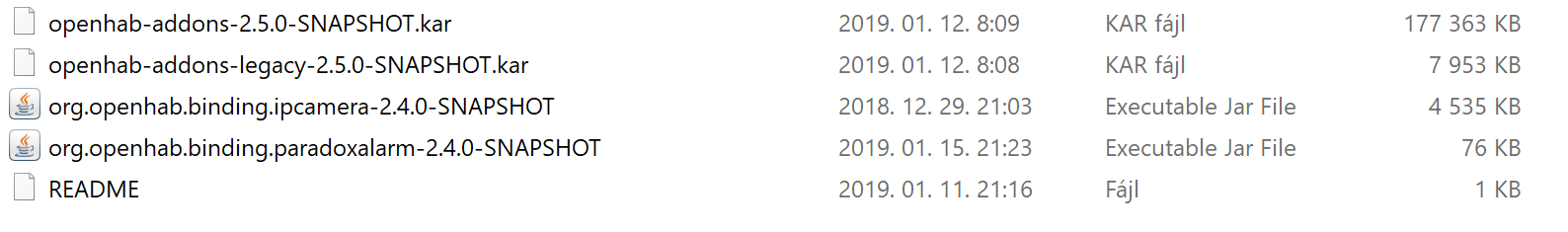

Just to clear, when can I expect it in the milestone build included? Currently I keep this binding’s jar file in addon folder besides the normal addon files.

I updated to openHAB 2.5.0 Build #1512 and downloaded org.openhab.binding.paradoxalarm-2.5.0-SNAPSHOT.jar. It works without any problem. Thanks. Binding is not included this OH version. I had to put jar file to addon folder.
Thanks for testing!
Until the PR is approved the procedure will be manual download of .jar → put under addons folder.
I’ll put a note here if/once the pull request has been integrated in main openhab addons.
