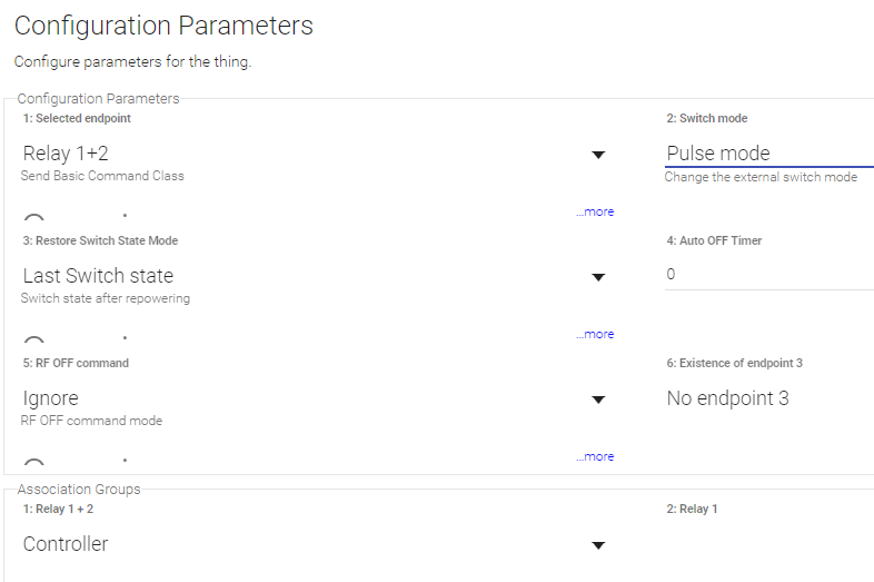

Is this relay working for you?
I’m trying to get the same model (PAN06-1B) getting to work.
But can’t figure out the manual.
When I fe close a relay, another one closes, and all relays get on…
I don’t use the switches, only the relays.
Relay means switch endpoint - in this model you have two endpoints (switches), so you can use it for two lamps.
Switch mode means a type of switch reaction:
  • edge mode - it should behave like standard switch on/off
  • pulse mode - it’s for door bell
  • edge toggle mode - it reacts on voltage change
