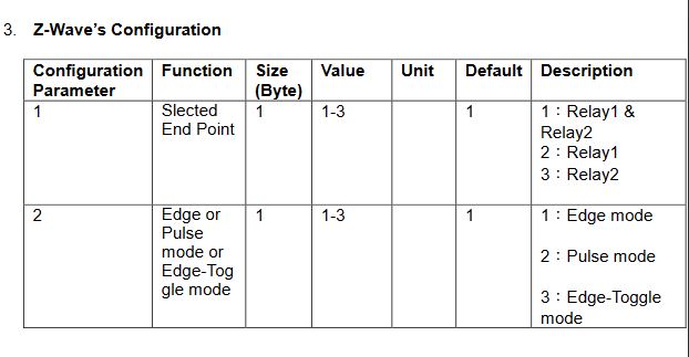

Manual version on cd-jackson page is 2013 for PAN06-1.

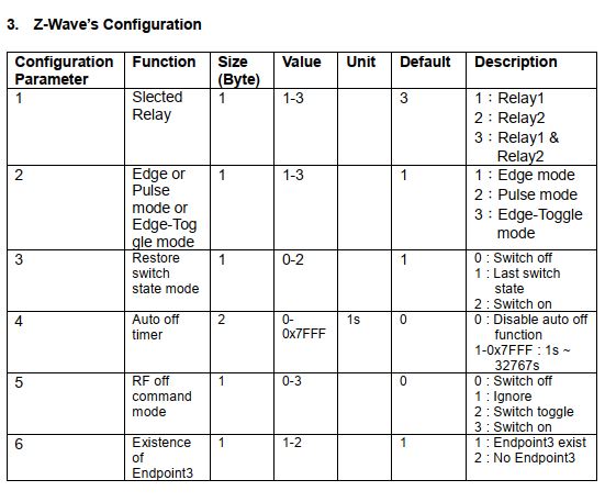

Manual for my version of switch is 2015 for PAN06-1B.

Current database entry only lists these parameters:
According to your manual you have more parameters:
I’m not sure if we just can add those or if the firmware version has changed and we need a new entry in the database. We need to ping @chris if he has time to take a quick look.
Unfortunately the config parameter for option 1 has changed for your device, too: 1 is now “Relay 1”, while the current one in the database states for option 1 “Relay 1+2”
Meanwhile please post your firmware version.
Firmware version: 1.8
It looks like it’s probably best to create a new version - assuming the manuals are correct, the parameters are definately different and it would be better to use a new version.
