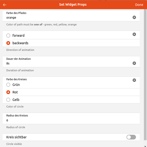

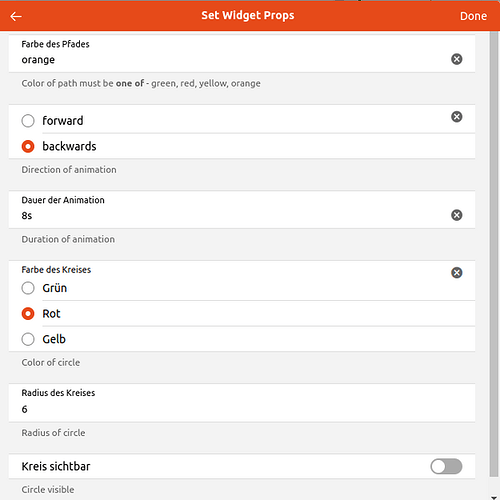

The following window appears for the props:
You can see that the default values are entered here, but not the implicit default value for BOOLEAN.
For the duration specifications, I did without
 limitToOptions: true
Therefore, the defaults only appear if you delete the input field, but free entries such as 32s are also possible.
