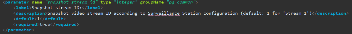

I’ve got an issue with my bundle Synology Surveillance Station Binding and the latest 3.3.0-STABLE
There is a config parameter, defined as integer :

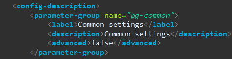

with its corresponding group:
Normally I’m parsing this value using:
int streamId = Integer.parseInt(thing.getConfiguration().get("snapshot-stream-id").toString());

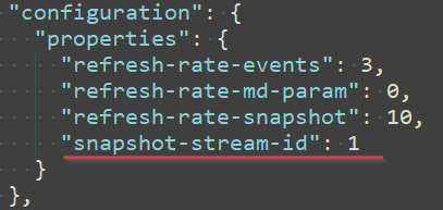

If I’m looking into
\userdata\jsondb\org.openhab.core.thing.Thing.json
I see my parameter properly set:
This value stays persisted upon OH restart.
