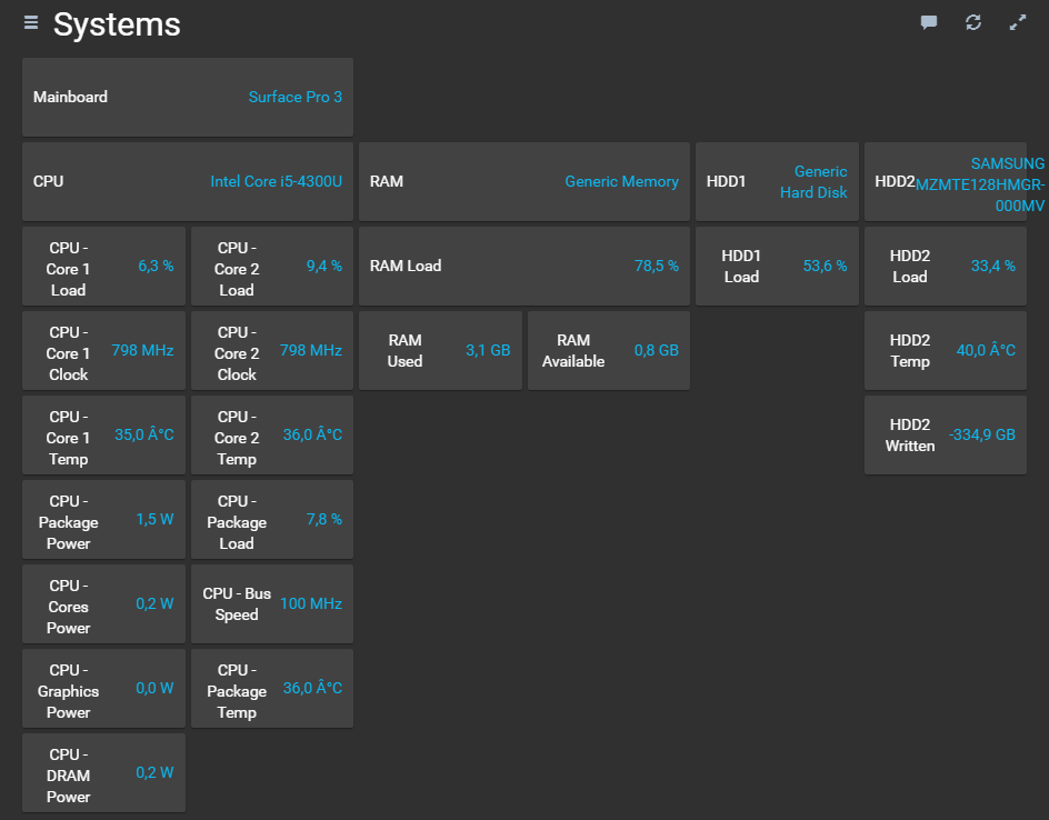

doing this, the items do show up in paperUI but only string items show in HABmin and HABpanel does allow binding items to dummy widgets but they all just display null.
im sure im missing something here. this is my first time setting up openhab after all and im really not fully in the know about inner workings of it yet.
can someone maybe already tell some stupid mistake i made or step i overlooked?

openhab.log does contain the same error a bunch of times:
2020-02-20 13:10:23.544 [ERROR] [org.apache.felix.configadmin        ] - [org.osgi.service.cm.ManagedService, org.osgi.service.event.EventHandler, id=520, bundle=291/mvn:org.openhab.binding/org.openhab.binding.http/[1.14.0,1.15)]: Unexpected problem updating configuration org.openhab.http
java.lang.NumberFormatException: For input string: "1000.0"
	at java.lang.NumberFormatException.forInputString(NumberFormatException.java:65) ~[?:1.8.0_241]
	at java.lang.Integer.parseInt(Integer.java:580) ~[?:1.8.0_241]
	at java.lang.Integer.valueOf(Integer.java:766) ~[?:1.8.0_241]
	at org.openhab.binding.http.internal.HttpBinding.updated(HttpBinding.java:535) ~[?:?]
	at org.apache.felix.cm.impl.helper.ManagedServiceTracker.updated(ManagedServiceTracker.java:189) ~[bundleFile:?]
	at org.apache.felix.cm.impl.helper.ManagedServiceTracker.updateService(ManagedServiceTracker.java:152) [bundleFile:?]
	at org.apache.felix.cm.impl.helper.ManagedServiceTracker.provideConfiguration(ManagedServiceTracker.java:85) [bundleFile:?]
	at org.apache.felix.cm.impl.ConfigurationManager$UpdateConfiguration.run(ConfigurationManager.java:1405) [bundleFile:?]
	at org.apache.felix.cm.impl.UpdateThread.run0(UpdateThread.java:138) [bundleFile:?]
	at org.apache.felix.cm.impl.UpdateThread.run(UpdateThread.java:105) [bundleFile:?]

yes. i just switched them all to string (was easier than changing a single one) and the values are displayed correctly.
but you are right the jon only contains strings and i need to figure a way to parse them so i can display them properly in charts and dials or whatever
looking at it a simple .split(’ ').get(0) should do the trick i think but i dont know where to put that. do i need a transformation or something?
Previous post updated with possible courses of action.
It would be really really helpful if statements like that were accompanied by what is actually displayed. You get units, right? We cannot see what you see.
sorry, youre right heres a screenshot of a roughly thrown together habpanel where all items are strings
Off-topic - Interesting it struggles with the degrees symbol, code mismatch somewhere.
yeah i was wondering about that as well. looks like ome encoding mismatch but not sure where to look for that yet and would be irrelevant i think if i only really want the number anyway
