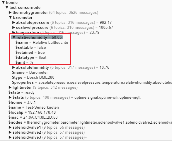

The homie node looks like this:
Unit is set to %.
openHAB is receiving the value as decimal instead of percentage:
2020-04-29 22:11:44.291 [vent.ItemStateChangedEvent] - OU_Backyard_RelativeHumidity changed from 0.5009 % to 0.5005 %

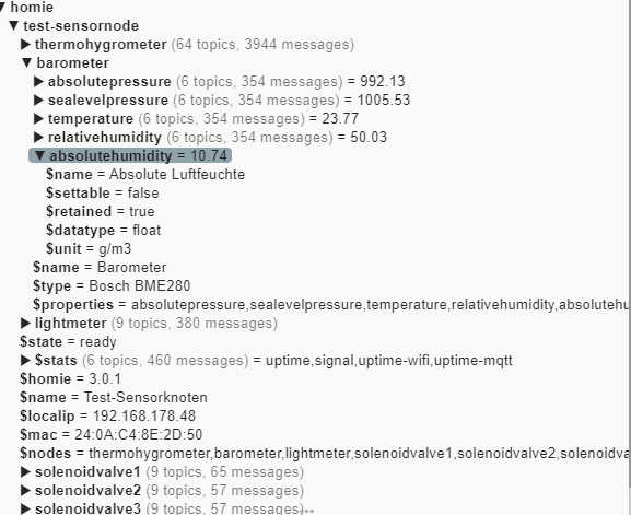

For example if i get the absolute humidty from the ESP32 (unit g/m3).
Number          			  OU_Backyard_AbsoluteHumidity         "Absolute Luftfeuchte [%.2f g/m³]"                                         <humidity>                      (OU_Backyard)                                                             			       {channel="mqtt:homie300:mosquitto:test-sensornode:barometer#absolutehumidity"}
The log viewer doesn’t display a unit:
2020-04-29 22:16:36.307 [vent.ItemStateChangedEvent] - OU_Backyard_AbsoluteHumidity changed from 10.78 to 10.79
How can i get the unit there? Although it is showing correctly in the sitemap.

My second question is solved:
2020-04-30 08:48:38.645 [vent.ItemStateChangedEvent] - OU_Backyard_AbsoluteHumidity changed from 11.32 g/m³ to 11.29 g/m³
Number:Dimensionless          OU_Backyard_AbsoluteHumidity         "Absolute Luftfeuchte [%.2f g/m^3]"                                        <humidity>                      (OU_Backyard)                                                             			       {channel="mqtt:homie300:mosquitto:test-sensornode:barometer#absolutehumidity"}

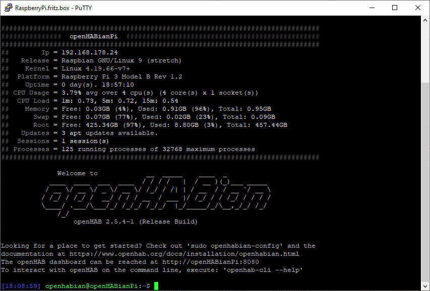

Sounds great but I can’t confirm this yet. I am using the stable release of 2.5.4 and it is not working. Do I have to install some milestone?
I am on OH 2.5.4-1
Need to clarify - are you having issues with your humidity item?

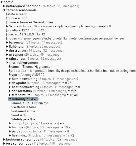

I think I have the same build as you:
It is happening to all humidity items through Homie.
This one for example:
As you can see. A value of 54.40 in sent via MQTT with unit %.
OpenHab converts it to 0.544 %:

Number:Dimensionless          GF_Terrace_Humidity                 "Rel. Luftfeuchte [%d %%]"                                                  <humidity>                      (GF_Terrace, gHumidity, Weather)                                    ["CurrentHumidity"]      {channel="mqtt:homie300:mosquitto:terrace-sensornode:thermohygrometer#humidity"}
And the Homie Things:
    Thing homie300  bedroom-sensornode   "Schlafzimmer Sensorknoten" @ "Schlafzimmer" [ deviceid="bedroom-sensornode" ]
    Thing homie300  bathroom-sensornode  "Badezimmer Sensorknoten"   @ "Badezimmer"   [ deviceid="bathroom-sensornode" ]
    Thing homie300  terrace-sensornode   "Terrasse Sensorknoten"     @ "Terrasse"     [ deviceid="terrace-sensornode" ]
Every other item from this Homie device is working as expected. Only humidity has problems by dividing the value by 100.
