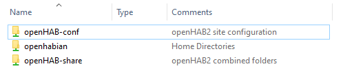

Now I cant access the samba folders through my windows 10 laptop.
The laptop asks for a username and password, but the standard ssh user and password seem to be wrong.

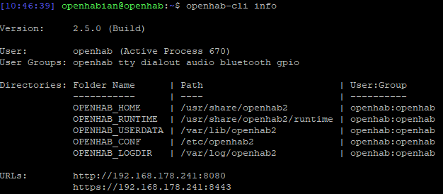

Besides that I don’t know what changed the permissions, does anyone know how to fix it?

Which is fine because openHAB runs as user openhab (only).
Bad idea. Use openhab-cli reset-ownership to change it back.
This is very strange, but I installed a samba app on my android phone and I can access the shares from there.
So must be something with my laptop, but what…
That is not neccessary and shouldn’t have any effect. Using an UNC path or a drive letter doesn’t matter for explorer access. Other windows applications may differ.
