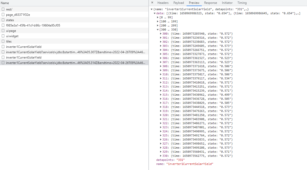

I verified that the data is stored in the database and data is retrieved as you can see in the network tab:
However the charts do not show any data.
Also when clicking on analyze on the item, nothing is shown.
Is there a known issue with the charts and jdbc?
I found only some old bug reports which seemed not directly related to this or mostly the issues have been related to the rrd4j persistence which I do not use.

And I think I found the issue. Had a look in the log files and realized that the timezone of the log entries has been wrong. I added a new environment variable to my docker deployment
variable: TZ
value: Europe/Vienna
Now the log timestamps are correct and the chart is showing some data.
So looks to me like a bug in openHAB because the chart itself showed the correct time-frame on the axis and the data from the database had the correct timestamp. Only the chart has not been drawn.
