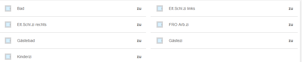

Unbenannt
and the items:
.. sorry only one image.. believe me, all windows are “zu”
