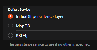

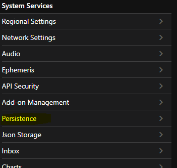

Hi Rob,
pretty sure you have to set your default persistence service to influx in the UI
See here:
Regards
