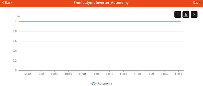

I’m new to openHAB, and I’m trying to better understand how persistence data works. I have a solar inverter, which reports a parameter called Autonomy. It is of type Number:Dimensionless, and during the day, it is usually 1.
When I run the following script (application/javascript;version=ECMAScript-2021), I get an output that seems inconsistent to me. As far as I can tell, these three values that I print to the log should all be 1. Is anyone able to help me understand where I am going wrong?

Do not trust GUI which may apply default units and conversions, do not trust charting (persistence) which may apply default units and conversions, look in your events.log or API Explorer.
For a Dimensionless, these two values are the same.
Its never clear to me if min/maxSince includes current Item state, I imagine it does. I’ll bet one of those is retrieved data and one is current state. Either is the “correct” answer for max/min when there’s been no change.
The averageSince has got into trouble, I would guess it is not properly converting in the 1==100% results in the absence of Item default unit - but that remains to be found out.
Note the “average” calculation is time-weighted - it might be trying to average 3 or 4 records and the current state e.g. 1,1,1,100

I suppose I am confused that the events.log shows values between 0% and 100%, while the persistence values from the API explorer are a ratio between 0 to 1.
2022-12-08 18:32:33.193 [INFO ] [openhab.event.ItemStateChangedEvent ] - Item 'FroniusSymoInverter_Autonomy' changed from 46.87730695408239 % to 86.47798742138365 %
2022-12-08 18:32:46.230 [INFO ] [openhab.event.ItemStateChangedEvent ] - Item 'FroniusSymoInverter_Autonomy' changed from 86.47798742138365 % to 100 %
