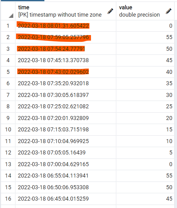

Based on that i set up a rule that is updating every five minutes a number item with the current Minite value. Additionally i set up a postgesql database to persist these value.
As you could see the timestamps sometimes differ significantly. My expectation on the timestamp was that the timestamp holds the time when the item was updated/changed and not the time the value was written to the database.

I don’t think that’s documented anywhere. Looking at the code for PostgreSQL I don’t see anywhere that the timestamp is actually passed when the entry is created so, assuming I’m reading the code correctly I think your expectation is incorrect and OH is relying on PostegreSQL to generate the timestamp instead. Here’s the SQL:
sqlCreateNewEntryInItemsTable = "INSERT INTO items (itemname) SELECT itemname FROM #itemsManageTable# UNION VALUES ('#itemname#') EXCEPT SELECT itemname FROM items";

The cron is done from HABApp, so a little different from the typical cron trigger. But i have check the time stamps in the logs. HabApp Log shows the right time (plu some millies) and the openhab Eventlog is showing the right time as well (plus some more millies), but the database vary the tomestamp sometime a little some times a lot. With the hourly trigger i found differences up to half an hour.
Tanks for checking the code. I think that is really an issue on persistence and i think all other binding will do it in the same way.
I know there is a way to insert values into the database through openHAB’s REST API that does allow you to set the timestamp yourself instead of relying on system time. You might be able to do something with that.
I think that there is an issue open on that, because i aked to implement that into the persitence funktion of HABApp. There we have found out that this feature is not implemented yet in the bindings
I have to check for the issue. But this would be great, because you could then write the right data at any time you want.
