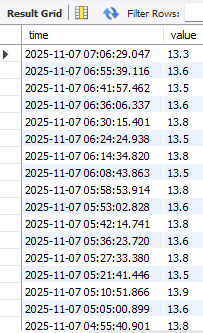

I have an odd persistence/chart issue since upgrading to OH5 that I’ve noticed recently. For detail, my setup is OH5.0.2 on RPI5 (openhabian) using JDBC with a MariaDB instance on my NAS. I have 3 shelly H&T’s tracking temp/humidity. I’ve confirmed that the shelly H&T’s are accessible, functioning, and tracking temp/humidity. I’ve also confirmed the MariaDB instance has current rows for all the temp/humidity data points for each Shelly up to the minute. The data looks fine as do the devices.

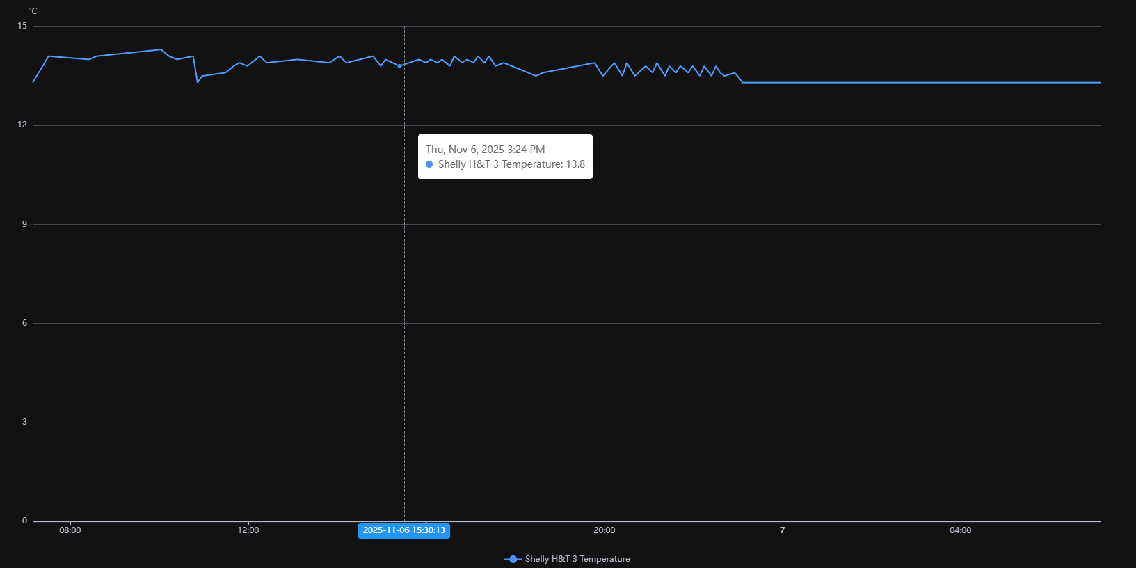

So if I run my chart for this H&T temperature I get this
What the chart seems to do is set a flat line for the last 8 hours despite the fact that the last 8 hours of data points are present in the mariadb instance. It’s always about 8 hours flat line.
