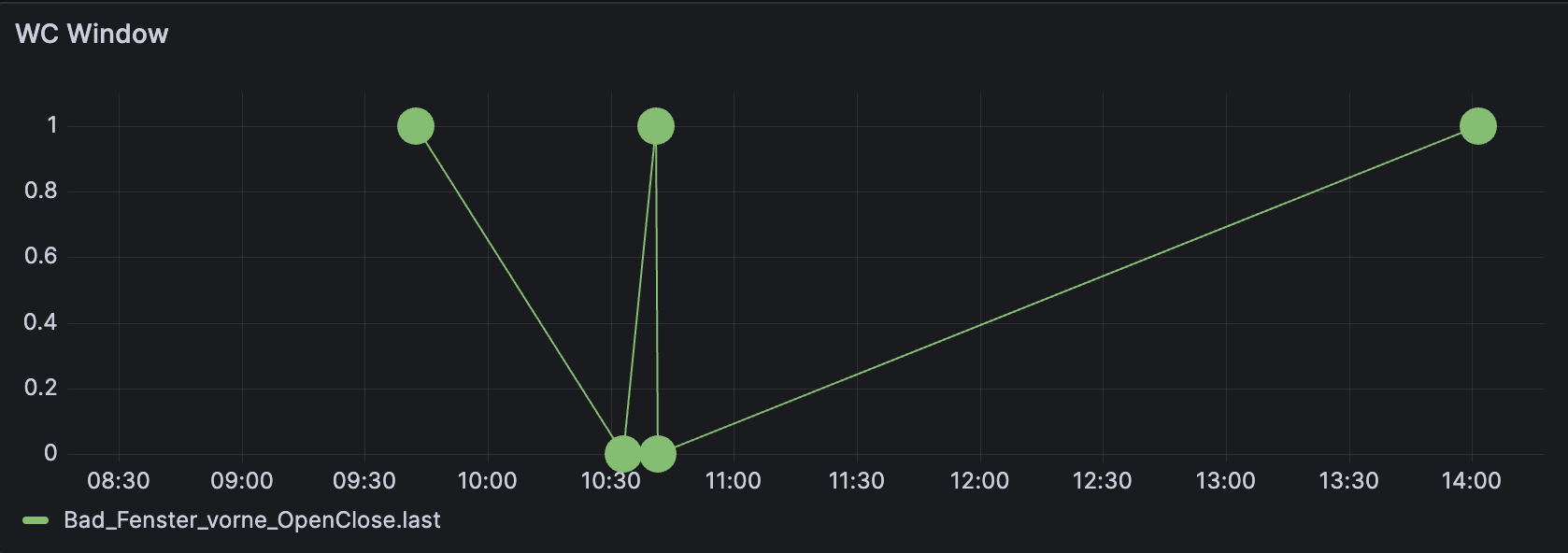

I store my ON/OFF sensor with the influx-db persistence.
What I currently have is what is depicted in the following example:
In this case the value was OFF at ~10:40 and became ON at 14:00
What I would like to have though is also the a point in the time serious where the value was OFF the last time like so
I could achieve that kind of by storing a value every other minute or second but that would generate unnecessary information.
I am currently using Grafana to show the values.

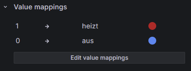

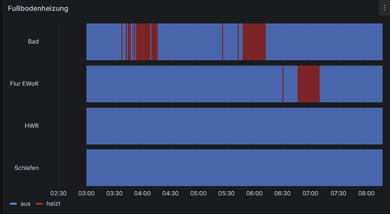

for visualization of the actors from my underfloor-heating i use the visualization-type “state timeline” and override the value-mappings like
to have a visualization like

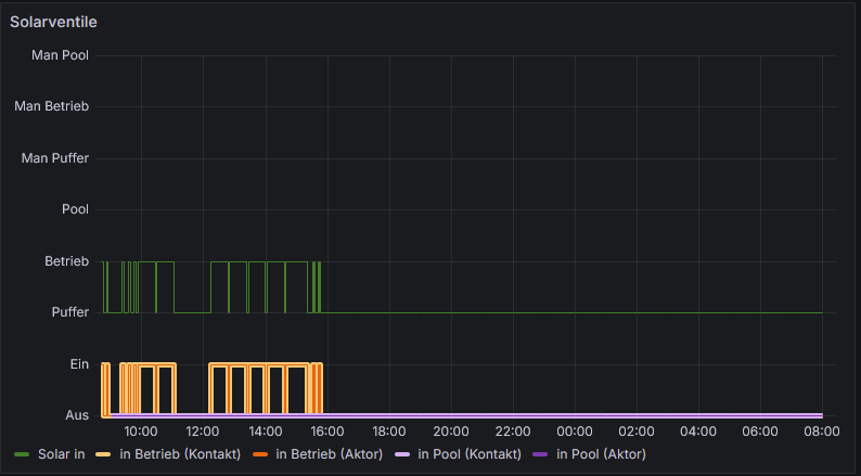

for visualization where to put warmwater solar (automatic / manual mode) i use the visualization-type “time series” (for contact and number items) and override the graph-style (as suggested in the two answers bevore) like

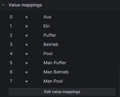

the value-mappings i override like
to receive a visualization like

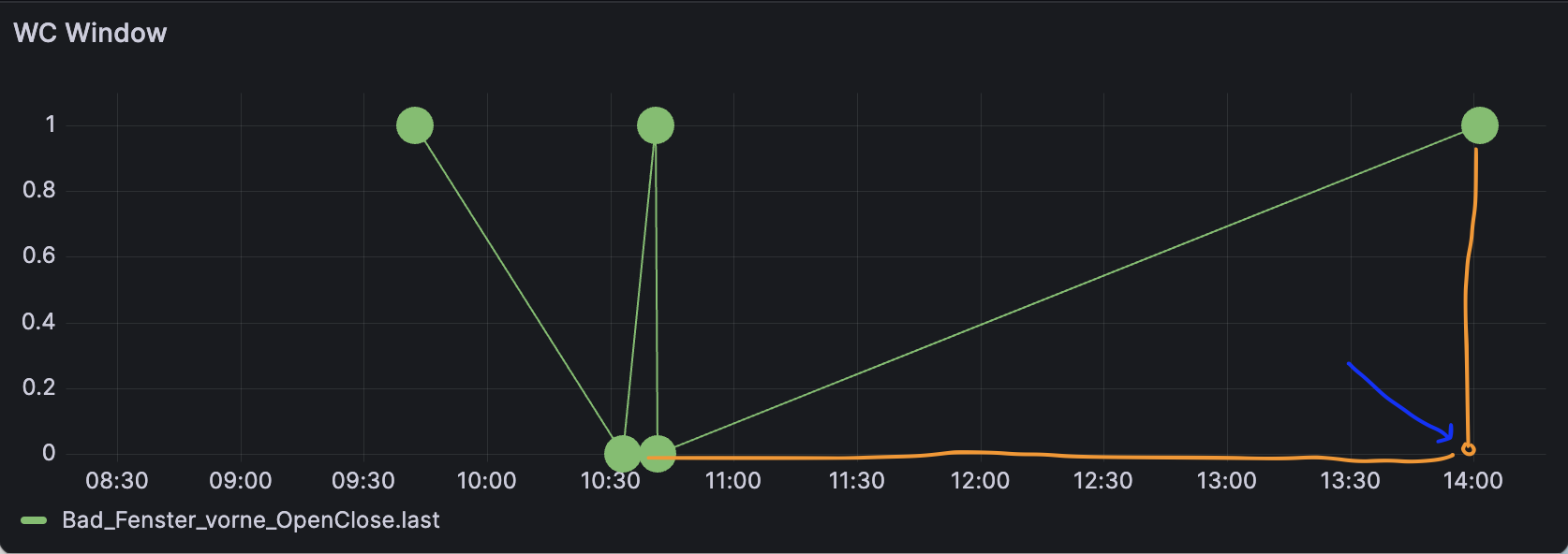

Where I wasn’t clear when I posted my question was that it is not so much about the visualization but rather that I like to have that value in the time series for computation:
The reason is that I have a rule that computes the time since the last change (“how much time has passed since the window/door was opened”. This rule didn’t really work with the persistence method “previous state value time” because the actually transition starting point is missing (see the blue arrow above). The green dot at let’s say 14:05 would compute 14:05 - 10:40 but not 14:05 - 14:00 which is totally wrong.
Note: I am aware that there would be other ways to achieve the same result but I was surprised that it doesn’t work with persistence “previous state value time” due to this missing transition starting point (I took me quite some time to understand why - only when I drew the above picture I started to understand).
I think the lastUpdate method from the persistence extensions should provided that time. The previousState would indeed come with the start time of the previous state.
You could argue that a lastChange method could also be useful to distinguish between update and change. But that does not exist in the persistence extensions.
Created a PR for that: https://github.com/openhab/openhab-core/pull/4259
