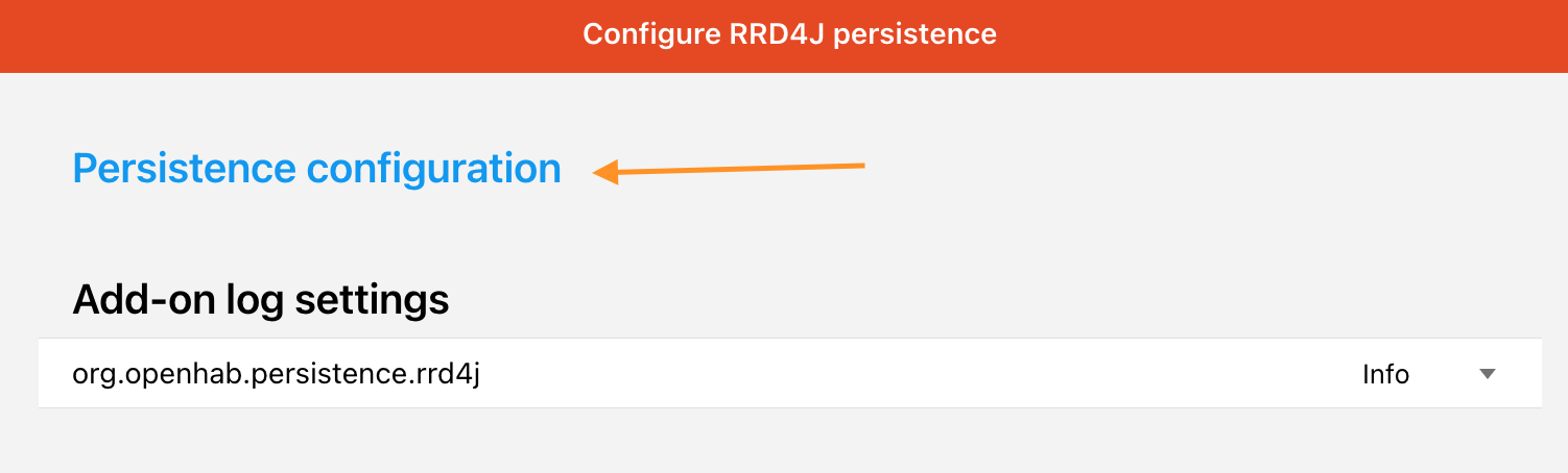

Yesterday, I configured persistence, using an SQL database. The weird outcome: once saving the connection information, the system immediately started storing items and their values with everyChange, although no .persist file was existing yet.
I thought I understood the documentation in a way that persistence in OH3 can only be configured using text files (.persist). And searching the GUI for almost an hour, I couldn’t find any context menu or config UI for things or items where a persistence definition could already be set up (despite the main persist config where the database connect information is placed).
And what is even weirder: the behavior (of storing values on everyChange) didn’t change when I actually placed a .persist file in the config directory, using an every5min configuration for the items in question. The persist file was recognized by the system as the openhab.log clearly confirmed. Yet, it didn’t make a difference, the system kept storing on everyChange, which led me to disable one thing (Shelly 3em) because it was flooding the database with values every second for several items.
