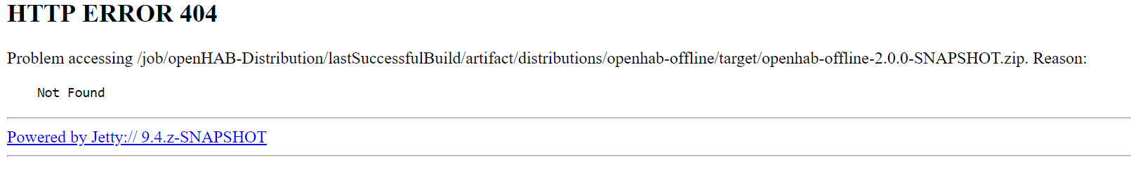

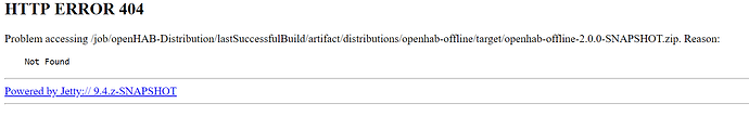

I haven’t installed the demo, the link provide for download fails?
