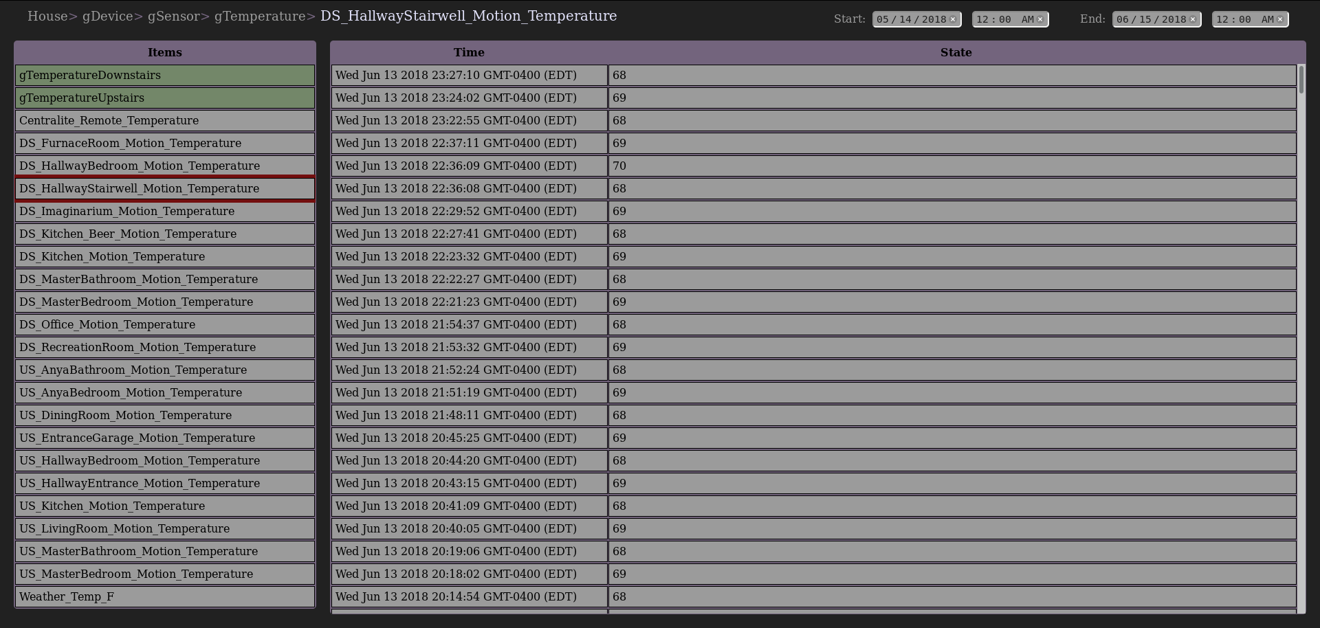

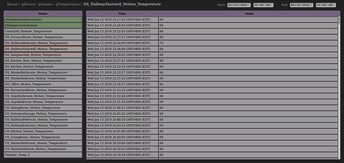

PersistenceViewer
I built a simple tabular persistence viewer in HTML, jQuery and AJAX. The first iteration was put together by my wife, using PHP, but I wanted something that I could easily put into HABPanel. A helpful web developer could probably condense it with more jQuery or rewrite it using AngularJS and make it a HABPanel template, but it’s working quite well for my purposes. Hopefully others will find it useful!
https://github.com/openhab-5iver/PersistenceViewer

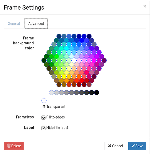

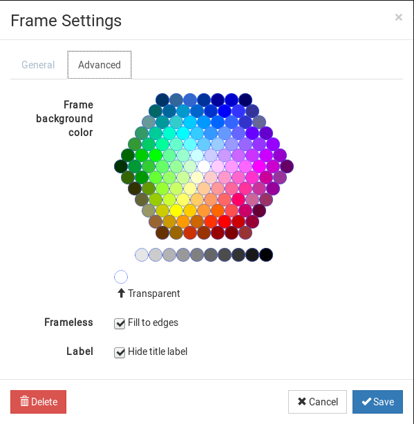

Here is how I have it configured in a Frame widget…
Known Issues:
  1. After changing the date range, you will need to select the Item name again to refresh the view.
