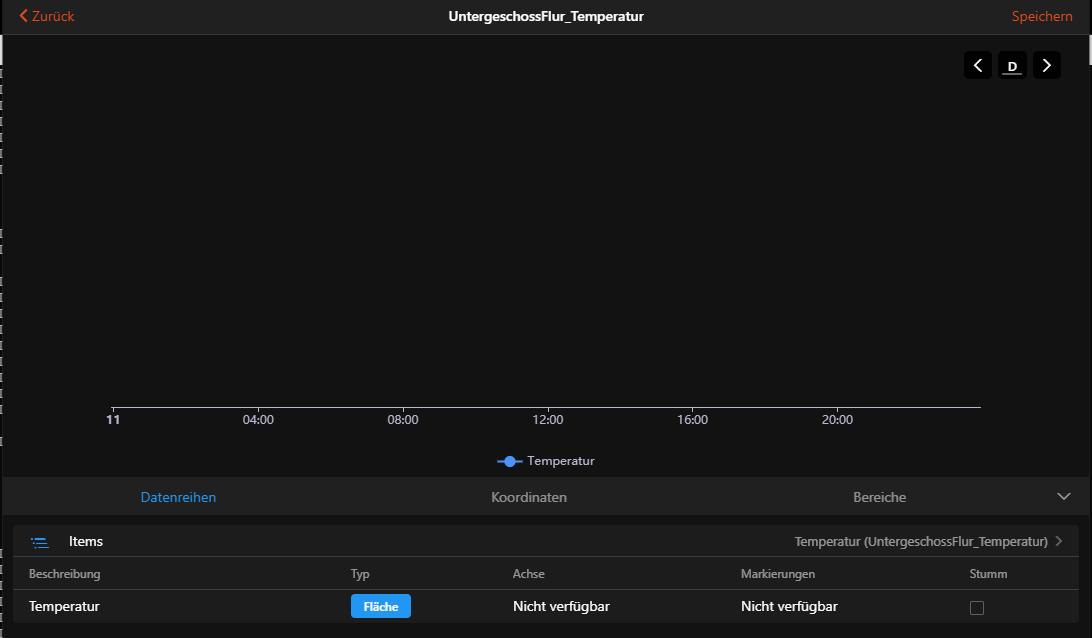

I wonder what I am doing wrong. I am missing the analyze graph on group items.
Config:
I can see “something” as the graph is part of the background of the widget,
but if I click on it, nothing will appear:
I can see the analyze-graph on each Temperatur Item,
but not on the group item .
I use version: 3.1.0.M3, but the problem exists since I started OH3 a couple of month ago.

Do you persist the group or the individual items?
And what’s the value of the group?
I assume I persist everything? see the astrix in the persistence-file.
something is persistent, because I can see the graph in the widget, just not the analyzer.
The value of the group is always the average of it’s members.
See
In summary, MainUI charting for Groups is not yet resolved.
I’m never sure about that, for Groups, which get special handling in persistence i.e. it wants to persist members instead.
You can use API explorer to verify you have data for the Group Item.
