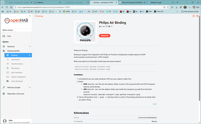

Why this addon version has no kar tag? Previous versions had it - https://community.openhab.org/t/philips-air-binding-4-0-0-0-5-0-0-0/ .
I try to find a marketplace add-on, which at the same time works with openHAB 5.2.0, and enables features, when installed over the market place. Thus it is distributed as KAR. In case the explanation is that it does not work this way, has it worked in the past, before openHAB 5?
yes, seems i missed the tag. it is there now

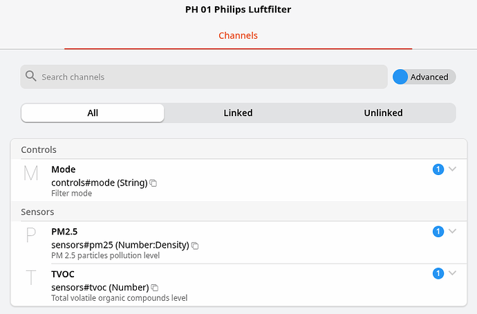

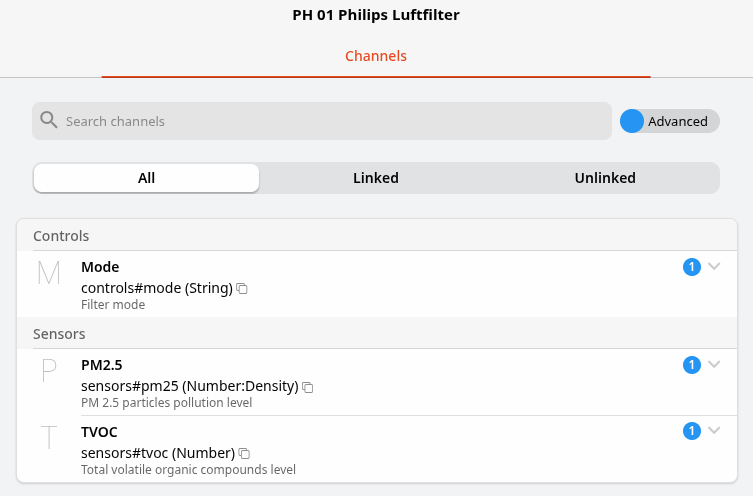

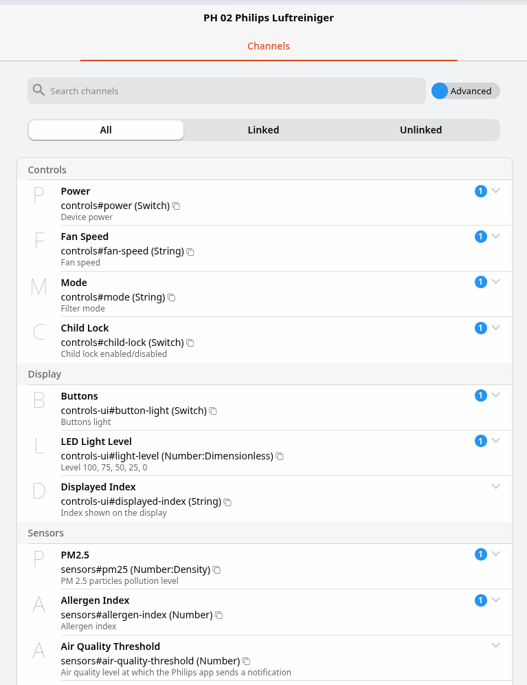

Raspi is updated to OH 5.2 snapshot under bookworm. Your latest binding is installed and is working.
That are the channels for device AC2939/10 (PH 01)
which were like the channels of AC0950/10 (PH02)
So for the older device most of the channels are gone.
Pls share a debug log, it will show the device responses and we can derive the right available channels
Did you remove the old thing and had it discover again?

Model AC 0950/10 shows 14 channels, but only some are receiving data.
data for : power , child lock, PM2.5 , Allergen index, prefilter , hepa filter
no data for : fanspeed,mode. button light, LED level, displayed index , air quality threshold, error message, carbon
Part of the log from AC 0950/10
16:35:10.064","DEBUG","org.openhab.binding.philipsair.internal.PhilipsAirHandler","Sending controls#mode as S"
"16:35:10.066","DEBUG","org.openhab.binding.philipsair.internal.connection.PhilipsAirCoapAPIConnection","Command '{""mode"":""S""}' is not supported by 192.168.1.76"
"16:35:10.079","DEBUG","org.openhab.binding.philipsair.internal.PhilipsAirHandler","Sending controls#mode as S"
"16:35:10.082","DEBUG","org.openhab.binding.philipsair.internal.connection.PhilipsAirCoapAPIConnection","Command '{""mode"":""S""}' is not supported by 192.168.1.76"
"16:35:21.243","DEBUG","org.openhab.binding.philipsair.internal.connection.PhilipsAirCoapAPIConnection","Status from 192.168.1.76: {""D01102"":0,""D01S03"":""Schlafzimmer"",""D01S04"":""Unicorn"",""D01S05"":""AC0950/10"",""D01107"":0,""D01108"":3,""D01109"":3,""D0110A"":0,""D0110B"":0,""D0110C"":18,""D01S0D"":""688001001366"",""D0110F"":3,""D01S12"":""0.3.3"",""D01213"":0,""ProductId"":""e3a1f43cfacc11ee974e06d016384e4a"",""DeviceId"":""fc50a199bceb11f18844e3188138d24e"",""otacheck"":false,""Runtime"":104267550,""rssi"":-23,""wifilog"":false,""blelog"":-1,""free_memory"":97712,""WifiVersion"":""AWS_Philips_AIR_Combo@86"",""StatusType"":""status"",""ConnectType"":""Online"",""D03102"":1,""D03103"":0,""D03104"":123,""D03105"":123,""D0310A"":2,""D0310C"":0,""D0310D"":1,""D03110"":0,""D03211"":0,""D03120"":1,""D03221"":3,""D0312A"":1,""D0312B"":1,""D0312C"":4,""D03130"":0,""D03134"":0,""D03136"":0,""D03240"":0,""D0313B"":20,""D05207"":720,""D05408"":9600,""D0520D"":662,""D0540E"":9542,""name"":""Schlafzimmer"",""modelid"":""AC0950/10"",""swversion"":""0.3.3"",""pwr"":""1"",""cl"":false,""iaql"":1,""pm25"":3,""fltsts0"":662,""fltsts1"":9542}"
