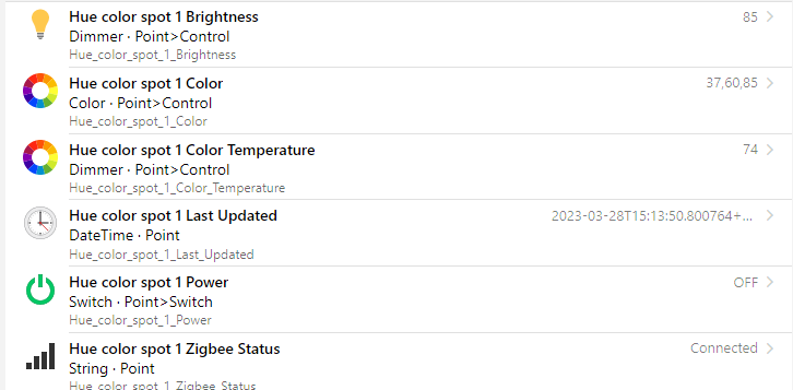

  • I do not seem to be getting updates back from the Hue Hub to openHAB. I can control the devices from openHAB, however if I turn on lights using the Hue APP, these changes do not seem to get to openHAB? I initially thought this was because I was using a group. But also tested with a single device and the same. The V1 devices on my production server still get updated (delayed)
  • Also noticed the Last Updated channel does not update, even though I have used openHAB to switch on/off etc.

Trace Logs as follows (Turned 3 groups On then Off):
15:13:41.186 [TRACE] [g.hue.internal.connection.Clip2Bridge] - onEventData() << [{"creationtime":"2023-03-28T13:13:40Z","data":[{"id":"3f746425-6c0f-4192-9540-9a85b7dd04db","id_v1":"/lights/4","on":{"on":true},"owner":{"rid":"ee1aa624-91b6-41f9-9921-e3ae2bae291d","rtype":"device"},"type":"light"},{"id":"164226b9-c8b2-485a-b8d8-269ca60019e1","id_v1":"/lights/5","on":{"on":true},"owner":{"rid":"18d47ab1-36fd-4c0f-8206-a95969f6b8b9","rtype":"device"},"type":"light"},{"id":"5666c6f5-71ab-478a-bd59-1308142cd999","id_v1":"/lights/6","on":{"on":true},"owner":{"rid":"d7aa1d72-009f-4b8d-a28f-798da9d7b33f","rtype":"device"},"type":"light"},{"id":"a7967b2a-bdb2-4b7c-955d-b54d363efabc","id_v1":"/lights/7","on":{"on":true},"owner":{"rid":"fb032c0c-4187-4f93-9bab-3ae1c3dc5567","rtype":"device"},"type":"light"},{"id":"58a9dd84-310a-44f8-b641-e555807e6bf4","id_v1":"/lights/8","on":{"on":true},"owner":{"rid":"0c18b50b-572f-4f50-ad3e-476293accd7b","rtype":"device"},"type":"light"},{"id":"224d33d8-ceb7-4a8d-a3c9-3c71c9996a59","id_v1":"/lights/1","on":{"on":true},"owner":{"rid":"6485b533-3d67-429c-89ff-e7ba813513f6","rtype":"device"},"type":"light"},{"id":"c00eff47-e666-4ff7-86c2-51f11fe8e713","id_v1":"/lights/2","on":{"on":true},"owner":{"rid":"9bb57c71-2a47-4eaf-a915-e55c7ac78d5b","rtype":"device"},"type":"light"},{"id":"8b0ca755-f39a-40cb-b46b-b538aec29091","id_v1":"/lights/3","on":{"on":true},"owner":{"rid":"4a1f8a73-3543-41f4-b4d9-173dc03747f5","rtype":"device"},"type":"light"},{"id":"c766b174-536e-4a2d-bc62-e3365c5229ae","id_v1":"/groups/0","on":{"on":true},"owner":{"rid":"bd9983ea-ce23-447e-95a8-cfd02bd037d7","rtype":"bridge_home"},"type":"grouped_light"},{"dimming":{"brightness":84.65},"id":"c766b174-536e-4a2d-bc62-e3365c5229ae","id_v1":"/groups/0","owner":{"rid":"bd9983ea-ce23-447e-95a8-cfd02bd037d7","rtype":"bridge_home"},"type":"grouped_light"},{"id":"ba365fdb-f055-410c-9021-561b725cdc22","id_v1":"/groups/1","on":{"on":true},"owner":{"rid":"dc30bab1-66e9-4b8e-9d9d-8725a770c515","rtype":"room"},"type":"grouped_light"},{"dimming":{"brightness":84.65},"id":"ba365fdb-f055-410c-9021-561b725cdc22","id_v1":"/groups/1","owner":{"rid":"dc30bab1-66e9-4b8e-9d9d-8725a770c515","rtype":"room"},"type":"grouped_light"}],"id":"dd7863cb-af7d-4de3-af1f-cd8bd745a7d5","type":"update"}]
15:13:41.189 [INFO ] [openhab.event.ItemStateChangedEvent  ] - Item 'Hue_color_spot_1_Power' changed from OFF to ON
15:13:41.189 [INFO ] [openhab.event.ItemStateChangedEvent  ] - Item 'Hue_color_spot_1_Last_Updated' changed from 2023-03-28T15:11:07.076379400+0200 to 2023-03-28T15:13:41.188049500+0200
15:13:41.190 [INFO ] [openhab.event.ItemStateChangedEvent  ] - Item 'LoungeRoom_Switch' changed from OFF to ON
15:13:41.190 [INFO ] [openhab.event.ItemStateChangedEvent  ] - Item 'LoungeRoom_Brightness' changed from 0 to 85
15:13:43.329 [INFO ] [openhab.event.ItemStateChangedEvent  ] - Item 'openHABServer_CPULoad' changed from 6.6 % to 5.3 %
15:13:48.334 [INFO ] [openhab.event.ItemStateChangedEvent  ] - Item 'openHABServer_MemoryUsed' changed from 68.2 to 68.4
15:13:48.337 [INFO ] [openhab.event.ItemStateChangedEvent  ] - Item 'openHABServer_CPULoad' changed from 5.3 % to 3.5 %
15:13:50.798 [TRACE] [g.hue.internal.connection.Clip2Bridge] - onEventData() << [{"creationtime":"2023-03-28T13:13:50Z","data":[{"id":"3f746425-6c0f-4192-9540-9a85b7dd04db","id_v1":"/lights/4","on":{"on":false},"owner":{"rid":"ee1aa624-91b6-41f9-9921-e3ae2bae291d","rtype":"device"},"type":"light"},{"id":"164226b9-c8b2-485a-b8d8-269ca60019e1","id_v1":"/lights/5","on":{"on":false},"owner":{"rid":"18d47ab1-36fd-4c0f-8206-a95969f6b8b9","rtype":"device"},"type":"light"},{"id":"5666c6f5-71ab-478a-bd59-1308142cd999","id_v1":"/lights/6","on":{"on":false},"owner":{"rid":"d7aa1d72-009f-4b8d-a28f-798da9d7b33f","rtype":"device"},"type":"light"},{"id":"a7967b2a-bdb2-4b7c-955d-b54d363efabc","id_v1":"/lights/7","on":{"on":false},"owner":{"rid":"fb032c0c-4187-4f93-9bab-3ae1c3dc5567","rtype":"device"},"type":"light"},{"id":"58a9dd84-310a-44f8-b641-e555807e6bf4","id_v1":"/lights/8","on":{"on":false},"owner":{"rid":"0c18b50b-572f-4f50-ad3e-476293accd7b","rtype":"device"},"type":"light"},{"id":"224d33d8-ceb7-4a8d-a3c9-3c71c9996a59","id_v1":"/lights/1","on":{"on":false},"owner":{"rid":"6485b533-3d67-429c-89ff-e7ba813513f6","rtype":"device"},"type":"light"},{"id":"c00eff47-e666-4ff7-86c2-51f11fe8e713","id_v1":"/lights/2","on":{"on":false},"owner":{"rid":"9bb57c71-2a47-4eaf-a915-e55c7ac78d5b","rtype":"device"},"type":"light"},{"id":"8b0ca755-f39a-40cb-b46b-b538aec29091","id_v1":"/lights/3","on":{"on":false},"owner":{"rid":"4a1f8a73-3543-41f4-b4d9-173dc03747f5","rtype":"device"},"type":"light"},{"id":"c766b174-536e-4a2d-bc62-e3365c5229ae","id_v1":"/groups/0","on":{"on":false},"owner":{"rid":"bd9983ea-ce23-447e-95a8-cfd02bd037d7","rtype":"bridge_home"},"type":"grouped_light"},{"dimming":{"brightness":0.0},"id":"c766b174-536e-4a2d-bc62-e3365c5229ae","id_v1":"/groups/0","owner":{"rid":"bd9983ea-ce23-447e-95a8-cfd02bd037d7","rtype":"bridge_home"},"type":"grouped_light"},{"id":"ba365fdb-f055-410c-9021-561b725cdc22","id_v1":"/groups/1","on":{"on":false},"owner":{"rid":"dc30bab1-66e9-4b8e-9d9d-8725a770c515","rtype":"room"},"type":"grouped_light"},{"dimming":{"brightness":0.0},"id":"ba365fdb-f055-410c-9021-561b725cdc22","id_v1":"/groups/1","owner":{"rid":"dc30bab1-66e9-4b8e-9d9d-8725a770c515","rtype":"room"},"type":"grouped_light"}],"id":"c290e81a-99ca-437f-a4ae-e9f292f2854c","type":"update"}]
15:13:50.800 [INFO ] [openhab.event.ItemStateChangedEvent  ] - Item 'Hue_color_spot_1_Power' changed from ON to OFF
15:13:50.801 [INFO ] [openhab.event.ItemStateChangedEvent  ] - Item 'Hue_color_spot_1_Last_Updated' changed from 2023-03-28T15:13:41.188049500+0200 to 2023-03-28T15:13:50.800764+0200
15:13:50.801 [INFO ] [openhab.event.ItemStateChangedEvent  ] - Item 'LoungeRoom_Switch' changed from ON to OFF
15:13:50.802 [INFO ] [openhab.event.ItemStateChangedEvent  ] - Item 'LoungeRoom_Brightness' changed from 85 to 0
15:13:53.347 [INFO ] [openhab.event.ItemStateChangedEvent  ] - Item 'openHABServer_MemoryUsed' changed from 68.4 to 67.9
15:13:53.353 [INFO ] [openhab.event.ItemStateChangedEvent  ] - Item 'openHABServer_CPULoad' changed from 3.5 % to 2.8 %
15:13:58.360 [INFO ] [openhab.event.ItemStateChangedEvent  ] - Item 'openHABServer_CPULoad' changed from 2.8 % to 1.1 %
15:14:01.278 [TRACE] [g.hue.internal.connection.Clip2Bridge] - onEventData() << [{"creationtime":"2023-03-28T13:14:01Z","data":[{"id":"6d1f0ce1-acfb-410c-866e-9c2a94a3c01b","id_v1":"/lights/18","on":{"on":true},"owner":{"rid":"cf8dbe0f-fc9a-4ac3-a5c8-743e5beed749","rtype":"device"},"type":"light"},{"id":"06236f4d-3175-4609-8cd5-fdf5764ad615","id_v1":"/lights/12","on":{"on":true},"owner":{"rid":"9ca6fe80-e5f2-4ea9-bcbe-f2c5ff565d53","rtype":"device"},"type":"light"},{"id":"2e657fe9-fd81-43b4-b4ec-c057ff00fbe1","id_v1":"/lights/11","on":{"on":true},"owner":{"rid":"3f922aa6-2647-483c-bb3f-c32ec8d7cce6","rtype":"device"},"type":"light"},{"id":"d9871d5d-02a0-4158-8b47-596f917b6340","id_v1":"/lights/10","on":{"on":true},"owner":{"rid":"42328b03-94e3-441c-a1e1-a174efff6f73","rtype":"device"},"type":"light"},{"id":"c766b174-536e-4a2d-bc62-e3365c5229ae","id_v1":"/groups/0","on":{"on":true},"owner":{"rid":"bd9983ea-ce23-447e-95a8-cfd02bd037d7","rtype":"bridge_home"},"type":"grouped_light"},{"dimming":{"brightness":75.2},"id":"c766b174-536e-4a2d-bc62-e3365c5229ae","id_v1":"/groups/0","owner":{"rid":"bd9983ea-ce23-447e-95a8-cfd02bd037d7","rtype":"bridge_home"},"type":"grouped_light"},{"id":"f1b79c17-908f-4d06-8450-46b6c4761b33","id_v1":"/groups/4","on":{"on":true},"owner":{"rid":"a781070d-57b2-433a-815f-2059eb63dacc","rtype":"room"},"type":"grouped_light"},{"dimming":{"brightness":75.2},"id":"f1b79c17-908f-4d06-8450-46b6c4761b33","id_v1":"/groups/4","owner":{"rid":"a781070d-57b2-433a-815f-2059eb63dacc","rtype":"room"},"type":"grouped_light"}],"id":"724831a1-3d86-40d7-bd4a-f2e7523861ad","type":"update"}]
15:14:01.280 [INFO ] [openhab.event.ItemStateChangedEvent  ] - Item 'RileyRoom_Switch' changed from OFF to ON
15:14:01.280 [INFO ] [openhab.event.ItemStateChangedEvent  ] - Item 'RileyRoom_Brightness' changed from 0 to 75
15:14:03.108 [TRACE] [g.hue.internal.connection.Clip2Bridge] - onEventData() << [{"creationtime":"2023-03-28T13:14:02Z","data":[{"id":"6d1f0ce1-acfb-410c-866e-9c2a94a3c01b","id_v1":"/lights/18","on":{"on":false},"owner":{"rid":"cf8dbe0f-fc9a-4ac3-a5c8-743e5beed749","rtype":"device"},"type":"light"},{"id":"06236f4d-3175-4609-8cd5-fdf5764ad615","id_v1":"/lights/12","on":{"on":false},"owner":{"rid":"9ca6fe80-e5f2-4ea9-bcbe-f2c5ff565d53","rtype":"device"},"type":"light"},{"id":"2e657fe9-fd81-43b4-b4ec-c057ff00fbe1","id_v1":"/lights/11","on":{"on":false},"owner":{"rid":"3f922aa6-2647-483c-bb3f-c32ec8d7cce6","rtype":"device"},"type":"light"},{"id":"d9871d5d-02a0-4158-8b47-596f917b6340","id_v1":"/lights/10","on":{"on":false},"owner":{"rid":"42328b03-94e3-441c-a1e1-a174efff6f73","rtype":"device"},"type":"light"},{"id":"c766b174-536e-4a2d-bc62-e3365c5229ae","id_v1":"/groups/0","on":{"on":false},"owner":{"rid":"bd9983ea-ce23-447e-95a8-cfd02bd037d7","rtype":"bridge_home"},"type":"grouped_light"},{"dimming":{"brightness":0.0},"id":"c766b174-536e-4a2d-bc62-e3365c5229ae","id_v1":"/groups/0","owner":{"rid":"bd9983ea-ce23-447e-95a8-cfd02bd037d7","rtype":"bridge_home"},"type":"grouped_light"},{"id":"f1b79c17-908f-4d06-8450-46b6c4761b33","id_v1":"/groups/4","on":{"on":false},"owner":{"rid":"a781070d-57b2-433a-815f-2059eb63dacc","rtype":"room"},"type":"grouped_light"},{"dimming":{"brightness":0.0},"id":"f1b79c17-908f-4d06-8450-46b6c4761b33","id_v1":"/groups/4","owner":{"rid":"a781070d-57b2-433a-815f-2059eb63dacc","rtype":"room"},"type":"grouped_light"}],"id":"46c22722-481c-4d79-aa44-dbd15f169d96","type":"update"}]
15:14:03.109 [INFO ] [openhab.event.ItemStateChangedEvent  ] - Item 'RileyRoom_Switch' changed from ON to OFF
15:14:03.109 [INFO ] [openhab.event.ItemStateChangedEvent  ] - Item 'RileyRoom_Brightness' changed from 75 to 0
15:14:03.368 [INFO ] [openhab.event.ItemStateChangedEvent  ] - Item 'openHABServer_CPULoad' changed from 1.1 % to 4.1 %
15:14:05.711 [INFO ] [openhab.event.ItemStateChangedEvent  ] - Item 'LocalTime_String' changed from 2023-03-28 15:13:05 SAST to 2023-03-28 15:14:05 SAST
15:14:05.712 [INFO ] [openhab.event.ItemStateChangedEvent  ] - Item 'LocalTime_Date_String' changed from 2023-03-28 15:13:05 SAST to 2023-03-28 15:14:05 SAST
15:14:05.768 [TRACE] [g.hue.internal.connection.Clip2Bridge] - onEventData() << [{"creationtime":"2023-03-28T13:14:05Z","data":[{"id":"b5b0089f-01cc-405e-9301-b9abe27ad3e9","id_v1":"/lights/14","on":{"on":true},"owner":{"rid":"45dd7454-2ae9-4a9b-90ca-b89e39023cbf","rtype":"device"},"type":"light"},{"id":"32d0c787-5bd2-40dc-b4d6-f229493a12e3","id_v1":"/lights/15","on":{"on":true},"owner":{"rid":"5d89d53f-165b-49ef-a2e5-34590fbe6fc4","rtype":"device"},"type":"light"},{"id":"1aaafabd-dc30-4f56-b2d4-9ec90b982383","id_v1":"/lights/16","on":{"on":true},"owner":{"rid":"6865d13e-18a1-4511-8fa3-c8251ce5cc3e","rtype":"device"},"type":"light"},{"id":"9b925046-9253-4a70-af58-9cfc8af88fa5","id_v1":"/lights/17","on":{"on":true},"owner":{"rid":"1a76d0a1-8dfb-404b-b6ba-3f5565405a85","rtype":"device"},"type":"light"},{"id":"c766b174-536e-4a2d-bc62-e3365c5229ae","id_v1":"/groups/0","on":{"on":true},"owner":{"rid":"bd9983ea-ce23-447e-95a8-cfd02bd037d7","rtype":"bridge_home"},"type":"grouped_light"},{"dimming":{"brightness":100.0},"id":"c766b174-536e-4a2d-bc62-e3365c5229ae","id_v1":"/groups/0","owner":{"rid":"bd9983ea-ce23-447e-95a8-cfd02bd037d7","rtype":"bridge_home"},"type":"grouped_light"},{"id":"f5f2fa98-94f2-4f60-977b-a8a4f454e6aa","id_v1":"/groups/5","on":{"on":true},"owner":{"rid":"0c3872fc-9c14-4d02-8ebc-bb3a8c142aea","rtype":"room"},"type":"grouped_light"},{"dimming":{"brightness":100.0},"id":"f5f2fa98-94f2-4f60-977b-a8a4f454e6aa","id_v1":"/groups/5","owner":{"rid":"0c3872fc-9c14-4d02-8ebc-bb3a8c142aea","rtype":"room"},"type":"grouped_light"}],"id":"93c24d84-2733-4d6d-8648-8eebad0bca36","type":"update"}]
15:14:05.770 [INFO ] [openhab.event.ItemStateChangedEvent  ] - Item 'EthanRoom_Switch' changed from OFF to ON
15:14:05.770 [INFO ] [openhab.event.ItemStateChangedEvent  ] - Item 'EthanRoom_Brightness' changed from 0 to 100
15:14:08.242 [INFO ] [openhab.event.ItemStateChangedEvent  ] - Item 'openHABServer_UsedHeapPercent' changed from 33 % to 41 %
15:14:08.377 [INFO ] [openhab.event.ItemStateChangedEvent  ] - Item 'openHABServer_CPULoad' changed from 4.1 % to 0.8 %
15:14:09.094 [INFO ] [openhab.event.ItemStateChangedEvent  ] - Item 'ShellyUNIshellyuni98cdac2c6bf210163199230_Temperature' changed from -17.5 °C to -16.5 °C
15:14:09.127 [INFO ] [openhab.event.ItemStateChangedEvent  ] - Item 'ShellyUNIshellyuni98cdac2c6bf210163199230_VoltageADC' changed from 27.69 V to 27.72 V
15:14:09.148 [INFO ] [openhab.event.ItemStateChangedEvent  ] - Item 'ShellyUNI_Battery_Charging_Count' changed from 28572.0 to 28573.0
15:14:09.206 [INFO ] [openhab.event.ItemStateChangedEvent  ] - Item 'ShellyUNI_Battery_Updated' changed from 2023-03-28T15:13:08.961911800+0200 to 2023-03-28T15:14:09.127308300+0200
15:14:09.207 [INFO ] [openhab.event.ItemStateChangedEvent  ] - Item 'ShellyUNI_Voltage_Update_Diff' changed from 58 to 60
15:14:09.208 [INFO ] [openhab.event.ItemStateChangedEvent  ] - Item 'ShellyUNIshellyuni98cdac2c6bf210163199230_VoltageADC_1min_AVG' changed from 27.63 V to 27.69 V
15:14:09.208 [INFO ] [openhab.event.ItemStateChangedEvent  ] - Item 'ShellyUNIshellyuni98cdac2c6bf210163199230_VoltageADC_1min_AVG_Diff' changed from -0.04 V to 0.01 V
15:14:09.210 [INFO ] [openhab.event.ItemStateChangedEvent  ] - Item 'ShellyUNIshellyuni98cdac2c6bf210163199230_VoltageADC_1min_Delta' changed from 0.01 V to -0.05 V
15:14:09.210 [INFO ] [openhab.event.ItemStateChangedEvent  ] - Item 'ShellyUNIshellyuni98cdac2c6bf210163199230_VoltageADC_1min_Delta_1m_AVG' changed from 0 V to 0.01 V
15:14:09.402 [INFO ] [openhab.event.ItemStateChangedEvent  ] - Item 'ShellyEM_UPS_Watt' changed from 397.7 W to 416.97 W
15:14:09.403 [INFO ] [openhab.event.ItemStateChangedEvent  ] - Item 'ShellyEM_UPS_TotalEnergy' changed from 6822.742 kWh to 6822.749 kWh
15:14:09.404 [INFO ] [openhab.event.ItemStateChangedEvent  ] - Item 'ShellyEM_UPS_ReactiveWatt' changed from -297.69 W to -315.39 W
15:14:09.405 [INFO ] [openhab.event.ItemStateChangedEvent  ] - Item 'ShellyEM_UPS_LastUpdate' changed from 2023-03-28T15:13:09.000+0200 to 2023-03-28T15:14:09.000+0200
15:14:09.406 [INFO ] [openhab.event.ItemStateChangedEvent  ] - Item 'ShellyEM_MAINS_Watt' changed from 1199.01 W to 1201.45 W
15:14:09.407 [INFO ] [openhab.event.ItemStateChangedEvent  ] - Item 'ShellyEM_MAINS_TotalEnergy' changed from 29854.766 kWh to 29854.786 kWh
15:14:09.407 [INFO ] [openhab.event.ItemStateChangedEvent  ] - Item 'ShellyEM_MAINS_ReactiveWatt' changed from 424.16 W to 438.73 W
15:14:09.408 [INFO ] [openhab.event.ItemStateChangedEvent  ] - Item 'ShellyEM_MAINS_LastUpdate' changed from 2023-03-28T15:13:09.000+0200 to 2023-03-28T15:14:09.000+0200
15:14:09.408 [INFO ] [openhab.event.ItemStateChangedEvent  ] - Item 'ShellyEM_UPS_VA' changed from -497.125 VA to -521.2125 VA
15:14:12.346 [TRACE] [g.hue.internal.connection.Clip2Bridge] - onEventData() << [{"creationtime":"2023-03-28T13:14:12Z","data":[{"id":"b5b0089f-01cc-405e-9301-b9abe27ad3e9","id_v1":"/lights/14","on":{"on":false},"owner":{"rid":"45dd7454-2ae9-4a9b-90ca-b89e39023cbf","rtype":"device"},"type":"light"},{"id":"32d0c787-5bd2-40dc-b4d6-f229493a12e3","id_v1":"/lights/15","on":{"on":false},"owner":{"rid":"5d89d53f-165b-49ef-a2e5-34590fbe6fc4","rtype":"device"},"type":"light"},{"id":"1aaafabd-dc30-4f56-b2d4-9ec90b982383","id_v1":"/lights/16","on":{"on":false},"owner":{"rid":"6865d13e-18a1-4511-8fa3-c8251ce5cc3e","rtype":"device"},"type":"light"},{"id":"9b925046-9253-4a70-af58-9cfc8af88fa5","id_v1":"/lights/17","on":{"on":false},"owner":{"rid":"1a76d0a1-8dfb-404b-b6ba-3f5565405a85","rtype":"device"},"type":"light"},{"id":"c766b174-536e-4a2d-bc62-e3365c5229ae","id_v1":"/groups/0","on":{"on":false},"owner":{"rid":"bd9983ea-ce23-447e-95a8-cfd02bd037d7","rtype":"bridge_home"},"type":"grouped_light"},{"dimming":{"brightness":0.0},"id":"c766b174-536e-4a2d-bc62-e3365c5229ae","id_v1":"/groups/0","owner":{"rid":"bd9983ea-ce23-447e-95a8-cfd02bd037d7","rtype":"bridge_home"},"type":"grouped_light"},{"id":"f5f2fa98-94f2-4f60-977b-a8a4f454e6aa","id_v1":"/groups/5","on":{"on":false},"owner":{"rid":"0c3872fc-9c14-4d02-8ebc-bb3a8c142aea","rtype":"room"},"type":"grouped_light"},{"dimming":{"brightness":0.0},"id":"f5f2fa98-94f2-4f60-977b-a8a4f454e6aa","id_v1":"/groups/5","owner":{"rid":"0c3872fc-9c14-4d02-8ebc-bb3a8c142aea","rtype":"room"},"type":"grouped_light"}],"id":"6398de32-a1ac-4f69-afed-5a7e34e22fa0","type":"update"}]
15:14:12.348 [INFO ] [openhab.event.ItemStateChangedEvent  ] - Item 'EthanRoom_Switch' changed from ON to OFF
15:14:12.348 [INFO ] [openhab.event.ItemStateChangedEvent  ] - Item 'EthanRoom_Brightness' changed from 100 to 0
15:14:13.385 [INFO ] [openhab.event.ItemStateChangedEvent  ] - Item 'openHABServer_CPULoad' changed from 0.8 % to 3.4 %
15:14:18.391 [INFO ] [openhab.event.ItemStateChangedEvent  ] - Item 'openHABServer_CPULoad' changed from 3.4 % to 2.7 %

EDIT: 15h29 - I also just noticed that the device has updated:
But delayed by >15 munutes?

@Mark_VG many thanks for the logs. This is just what I need for testing! Brilliant!
A few remarks..
  • Your bridge is on the same latest firmware version as mine, and it is definitely ‘talking’ the CLIP 2 API language.
  • The onEventData() messages are positive evidence that SSE eventing is working properly. You should see one (or possibly more than one) such onEventData() messages, immediately, any time that a light, group, or switch is operated.
  • As a fall-back to the onEventData() messages (which should cause an immediate state update in OH), the binding also does a regular HTTP GET for all devices at an interval of 10 minutes. This is just in case any onEventData() messages might have been lost.
  • The data in your logs is very interesting, and I will need to analyse it more closely. For example it is interesting to see that you have an entertainment system, which I do not have, and which so far I have not implemented. And perhaps based on your log, I can add an implementation for it too.
