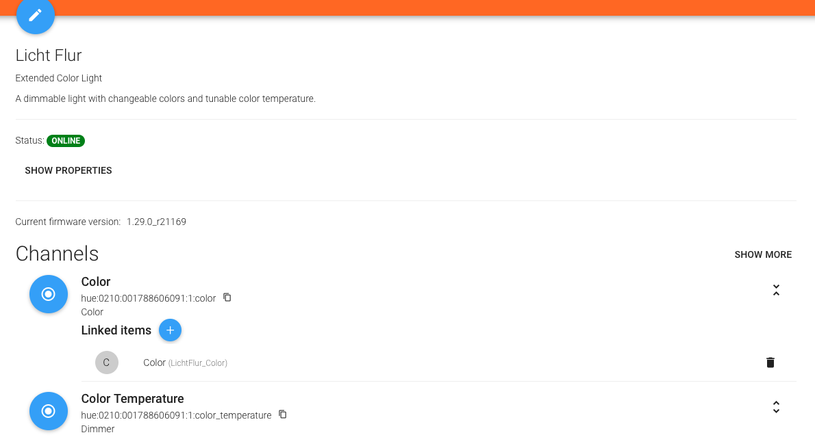

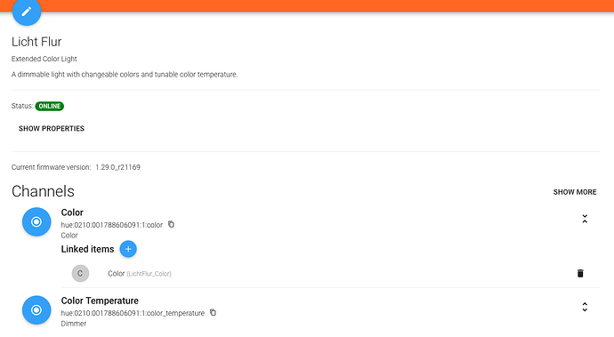

I added my HUE Lights in Paper Ui
so I have in Paper UI 3 Silders
with the Brightness Slider I can switch the lamp on and off.
So I add the Silder an a Colorwhell to my Basic ui
        Frame label="Flur" {
            Slider item=LichtFlur_Color icon="slider" label="Licht Flur [%s]" // Licht Flur
            Colorpicker item=LichtFlur_Color label="Farbe Licht Flur" // Licht Flur Farbtemperatur
The Problem is when I switch the Light of with the Colorwheel the slider stops in the middle, is there a way how I can “say” the slider "use the value “brightness” ?

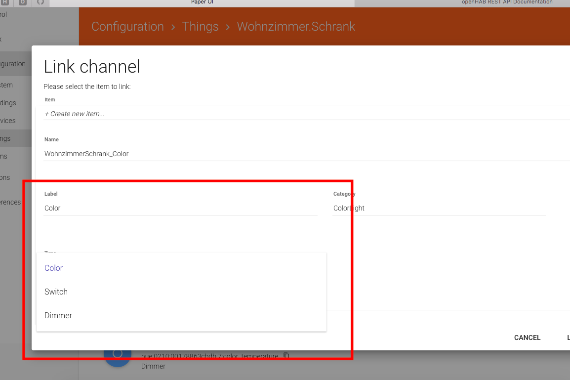

If I understood your Question right, than is my Answer … add a Dimmer Item to Color Channel. The Dimmer Item controlls the Britghness
But in Paper Ui I can can’t Add a Dimmer only Item.
In the wiki you can see Colour Light does not support a
Brightness thing.
??? You can … :wink:
The Wiki says that there is no OWN Channel for Brightness … The Brightness is inside the Color Channel
This works :wink:
