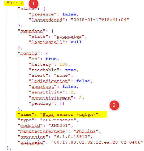

Let’s first check if the ID 25 is the correct one.
Just open a browser and check the result of your Hue Bridge by browing to:
http://192.168.1.135/api/3GhuhlTntnHxKuHYiFmAE**********/sensors
Of course your need to replace the * characters with your correct password.
If you read through the output (I used notepad++ to convert it into a readable format) you should see something like this.
Here it’s my ID number 3 for my motion sensor named “Flur sensor (unten)”

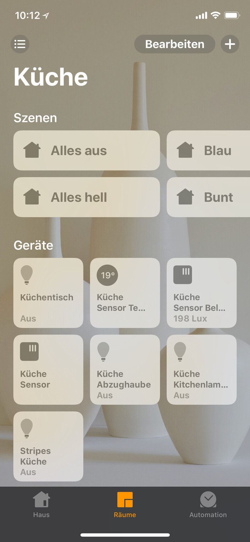

is 25 correct?
I Install the http binding and the Javascript and JSON Transformation but the Item says NULL :frowning:
25 is Küchensensor. So I guess this is the right one :slight_smile:
