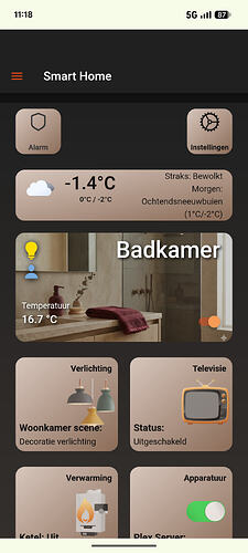

But now the second problem, I have a empty line above the main ui. It’s an extra row, as high as the title where also the hamburger menu is. I can remove it by adding code to the page a shown below but now I have to add that to every page I open with main ui. And I think it’s a global setting somewhere and adding this code to every page isn’t something I want.
style: --f7-safe-area-top: 0px
The strange thing is, when I open the main ui in the browser on the phone or the computer, the empty bar isn’t there.
I tested this on a iphone, the empty bar is there but the network switching > sitemap loading does not occur on iOS.
What could be the problem here for the Empty line above the main ui? And is this network change switch to sitemap normal behaviour on the android app?

This is the empy bar:
