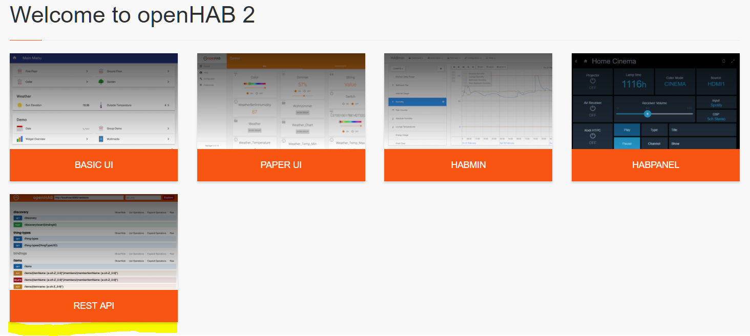

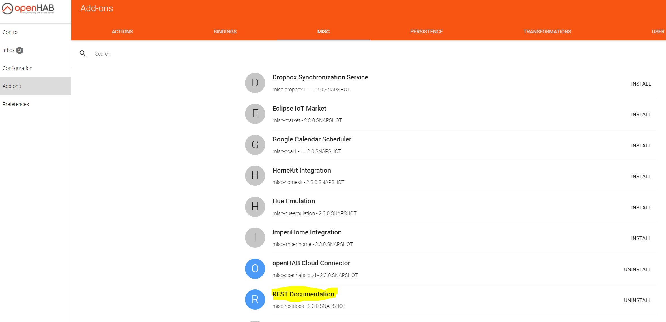

In paperUI there is even an interactive add-on documentation module:
Accessed from WEB top-level:

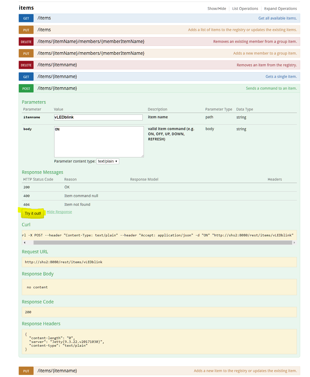

I have a virtual Switch item called vLEDblink
From the REST API documentation you can take the item control for a test drive:

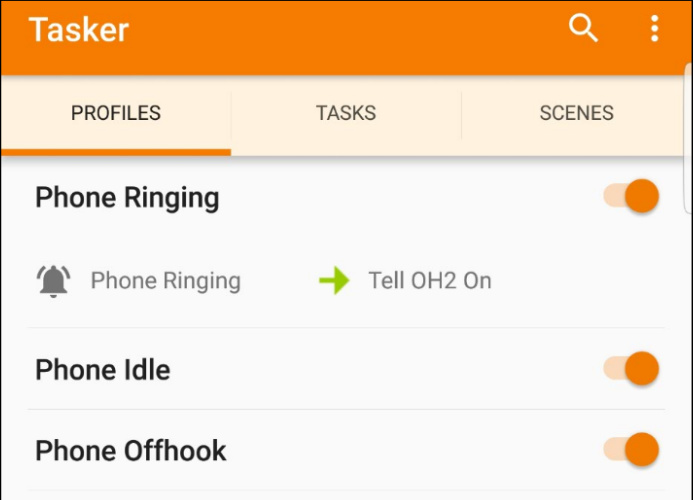

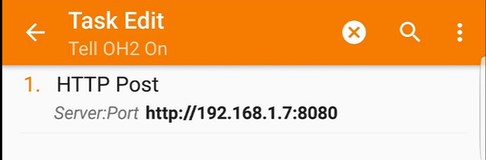

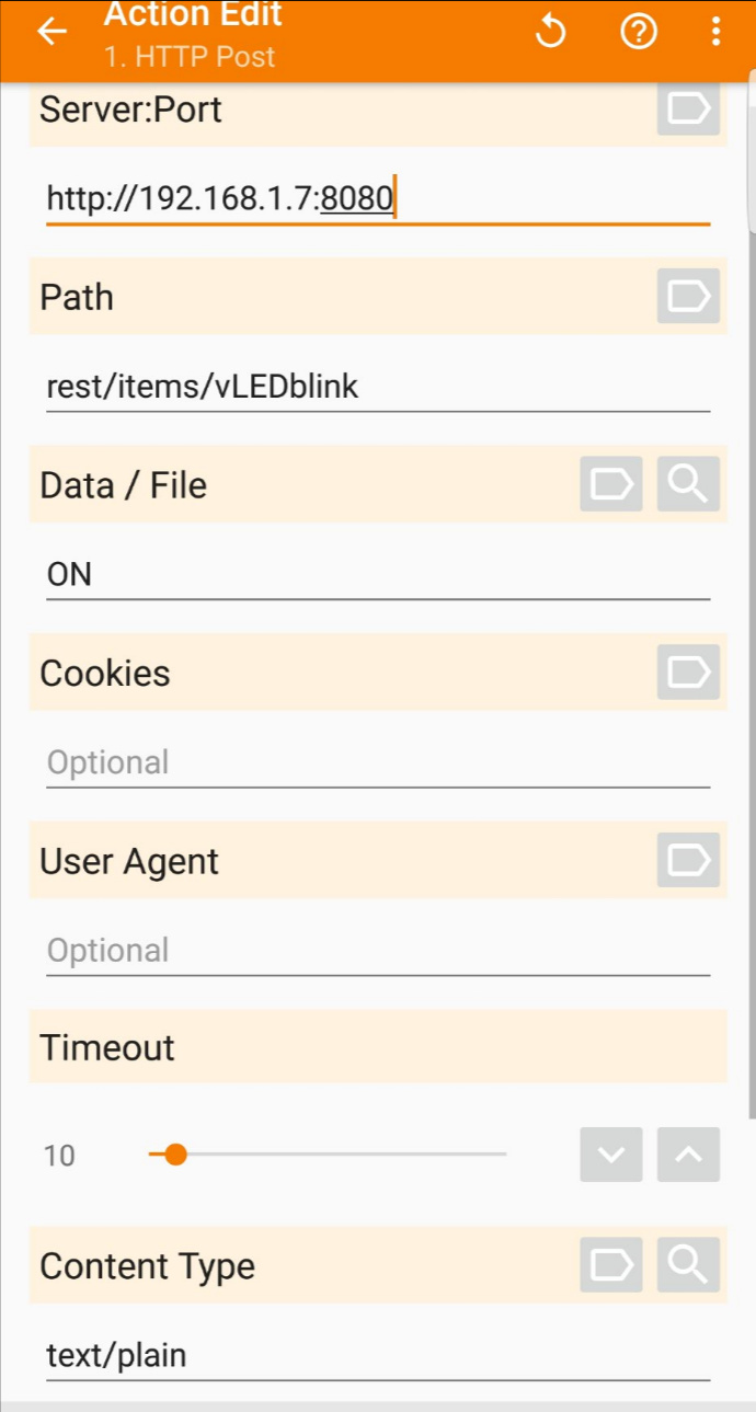

With this new insight, setting up Tasker was a breeze:

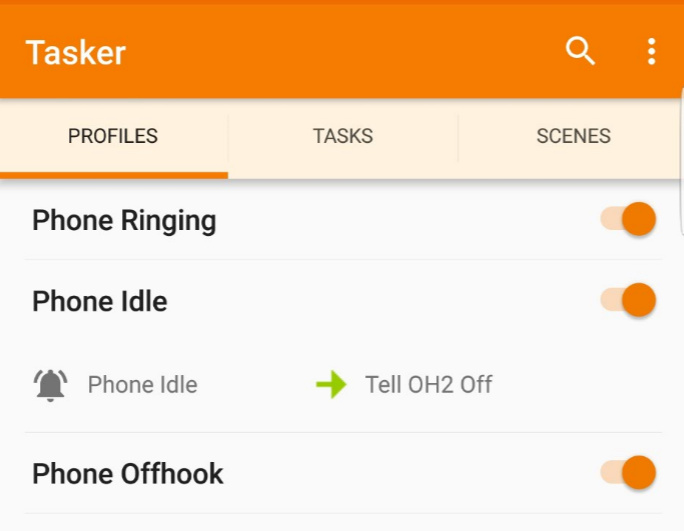

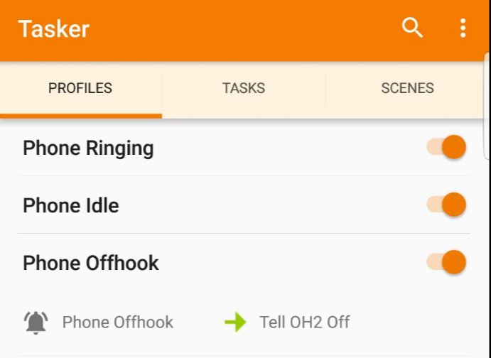

I wanted my virtual switch to be ON while the phone was ringing, and OFF when it either went off-hook or ringing stopped. Ended up with these 3 profiles:

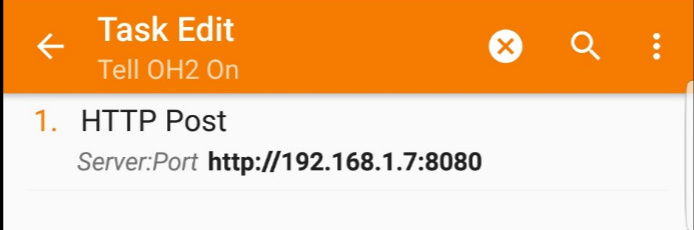

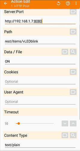

Tell OH2 On Task is like this:
Tell OH2 Off is similar except for OFF in the Data/File entry.
Works like a charm.
